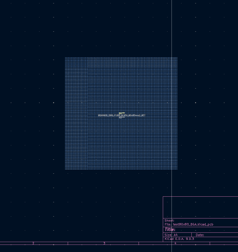

I’ve stumbled upon a problem in my current project. I’m designing a substrate and need to place a BGA on the bottom side. The BGA has 9801 balls – a 99x99 matrix.
Unfortunately, KiCad crashes immediately when I try to place the footprint. I can select the footprint, but as soon as it shows up in the layout, the program freezes and then closes—no error message, no autosave, just a crash. After that, the project reopens like nothing happened.
To check if it was a project-specific issue, I created a new empty project and tried again. Same result.
Has anyone else experienced similar problems or found a workaround for large BGA footprints in KiCad?

You don’t say what version you’re on. If you aren’t using 9.0.3, first update.
I would suggest to upload an example design showing this crash, so others can try to reproduce it easily.
Please upload this simplified project and details from Help - About KiCad - Copy version info
ownlocallib.pretty.zip (297.9 KB)
test80x80_BGA.zip (3.9 KB)
so here are the problematic files. I can’t upgrade to 9.0.3 for a different reason.
Had to black out the project path but its a serverlocation. Works fine in 9.0.2 not in 9.0.3. But this could also be a servererror and I didnt have time to look into it so far. So maybe this is a possible bug as well :smiley:

I just realised i mixed up rows and lines. Just in case someone is confused :smiley:
What a chonker!
no probs here. pretty fast too.

is there a reason to have pads on bottom? just curious.
It’s a substrate so basically a BGA Chip :smiley: so i need the pads on bot so they can go on top on the carrier PCB

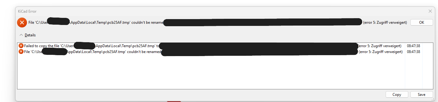

ok so 9.0.3 fixes this problem for me but i can’t save on this version see screenshot :smiley: any troubleshooting for this?
i could quickfix it most likely by copying project to local put in BGA then save revert so 9.0.2 and hope it doesnt crash but not realy the prefered solution.
I can place your footprint on 9.0.3++ Testing on Win11.
I can see it in 3D viewer and save.
It is unusual to have a footprint only on the B layer
If you use a 9.0.4 testing build (not a nightly build) this saving issue should be resolved, I think.
like this one ?
kicad-9.0-testing_9.0.3.359.g21ed7a0641-x86_64.exe today 1.1 GB
just to be sure is everything after 9.0.3.0 basically 9.0.4 testing?
Yes, exactly.
(This is the commit that fixes your save bug; it was added slightly after 9.0.3, so any build after that should work)
