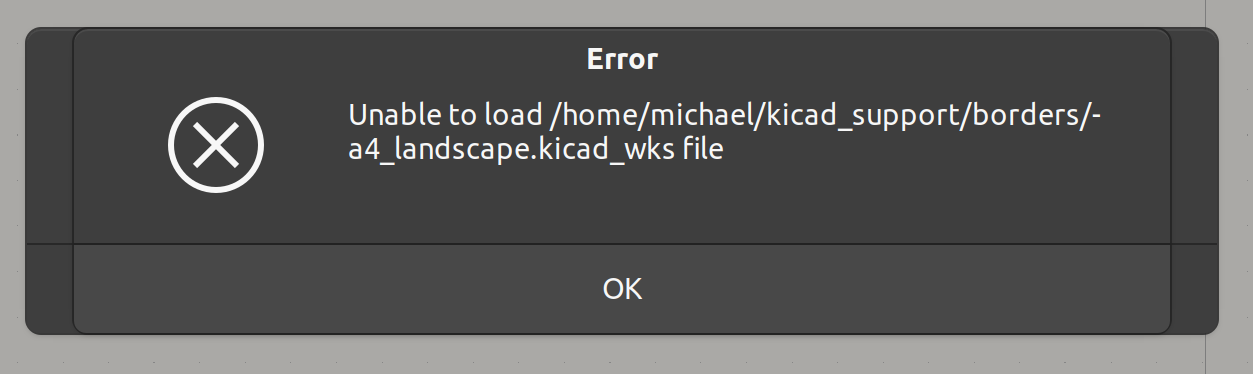

I changed from windows to linux. I am trying to get Kicad working. I have overcome hurdles with the lib paths and no libs being installed (because I first did sudo apt install kicad… big mistake).
This is the error I get when I try change the border (Schematic Editor → File → Page Settings → click dir icon to select a different file) from:
C:\work\kicad_support\borders\a4_landscape.kicad_wks
to
/home/michael/kicad_support/borders/a4_landscape.kicad_wks
I am not sure what to do, thanks for any guidelines!

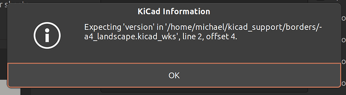

If I try open the border with the border editor I get:
The ok cannot be clicked, because there is a window behind it, that one needs to click first, but one can’t focus it or reposition the window in front of it to see what it is the issue.
This is the file:
(drawing_sheet
  (setup (textsize 1.875 2.5)(linewidth 0.25)(textlinewidth 0.25)
  (left_margin 10)(right_margin 10)(top_margin 10)(bottom_margin 10))
  (bitmap (name "bm1:Bitmap") (pos 31.5 6) (scale 1)
  (pngdata

Can you change drawing_sheet to page_layout and try to load again?
What magic is this? It worked! What is the difference? Why did it used to work but not anymore?
I really don’t know… I just looked the diff from the default *.kicad_wks in the official libraries and they had only this difference. :slight_smile:
Very clever! Thank you!
My best guess is you have some left overs from an old KiCad version from the “sudo apt install KiCad”.
When you then run KiCad it generates a configuration directory with settings, and these remain left behind when you uninstall KiCad.
Changing “drawing_sheet” to “page_layout” may seem a clever fix, but it is not a fix but a hack. It’s useful for diagnosis, but not to build upon.
The best way to proceed is very likely to completely uninstall KiCad, then delete the configuration directories and verify nothing is left behind and then re-install KiCad according to the instructions on the KiCad website.
Ah… It’s me and my low English level. This was not the only difference, this looks like a custom page.
What I should have said instead is: the only token difference.
I now think that this indeed might be a custom page leftover from v5, but i am not sure uninstalling everything is required.
A complete uninstall is probably not “required”, but it is simple and quick and very likely also effective.
What is the use of hunting down and fixing changes if it can also be fixed with a 5 minute re-install?
(And verifying the old configuration is really deleted probably takes up 3 of those 5 minutes).
For a KiCad developer working on improving conversion scripts hunting down such things is useful, but if you just want to get working with KiCad as a user you just want it to work, and a re-install is very likely the simplest and quickest solution.
I sudo apt install kicad from the Ubuntu’s packages (which are pretty official), and it did now work, no 3D libs).
I then followed the instructions on KiCAD’s website, that also did not work, all libs were “legacy” and modules paths broken.
To get KiCAD working, I actually followed this answer:
So after a new install the border that used to work, did not work, until I applied @Aris_Kimi’s fix (or hack). Maybe the border file spec changed from 5.99 to 6.0.4, if not I can’t fathom what happened because the border is under version control and has not changed.
It seems you were loading your own template file. My guess is that the keyword changed to page_layout, but your template file was for a previous version of KiCad.
