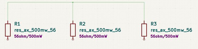

I’m struggling to see what the issue is here . . . in the top picture R2 is not connected while in the bottom picture it is. R1, R2 & R3 will be on the same net.

  1. Put three resistor as in my picture.
  2. Move cursor to left resistor top pin. Wiring tool switch on automatically.
  3. Draw wire from left resistor top pin to most right resistor.
Ok. Now it looks this.
  1. Put cursor to R2 top pin. Wiring tool is now automatically active.
  2. Click R2 top pin and draw wire from it to wire between R1 and R2. Cursor go exactly over it wire. Click. Older version: now junction appear. BUT Kicad 9 make this:
As you see. No connection.
  1. Put cursor to junction and press “J”. “Junction location contain no joinable wires and/or…”.
Summa summarum: Kicad 9 can make ONLY connection between two pin. It is no any jinx connect more. No W, no J, it is no any way force-connect.
So: Please tell me, what is it setting make this?

Ah now I see . . .
Found reason. My Kicad 9 was clear install and there was any “default bug”.
File > Schematic setup, Project/Net Classes: Default “Wire thickness” (and “Bus thickness”) was EMPTY. Now I put any value to it. (0.25 mm).
Now kicad make Junction. Without problem!
