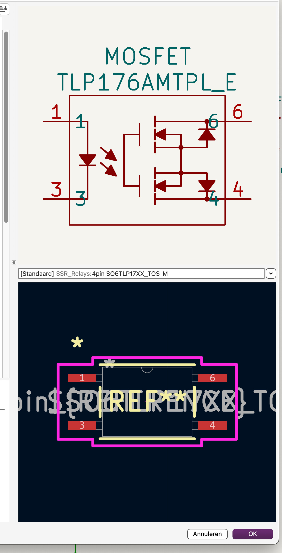

However, after closing and restarting KiCad, when I open the schematic editor and place a new symbol TLP176AMTPL_E, the footprint preview still shows the error:
Invalid footprint specified.
How can I fix this? Is there a way tocheck if the .kicad_mod files are okay?

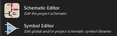

  1. When editing a symbol in the Symbol Editor, the footprint location is determined by opening the symbol properties and editing the footprint.(But why aren’t my edits reflected even though I made them? That’s the question.)
  2. There are two ways to start the Symbol Editor: from the Schematic Editor or from the Project Manager.
3.1. When launch it from the schematic editor, the following screen will appear:
3.2. If launch the symbol editor directly from the project manager, see something like this:
  1. The results will be different between 3.1 and 3.2.

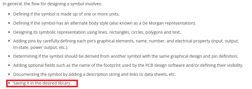

Kicad does not have components with combined symbols, footprints and 3D images. Kicad has symbols and footprints and 3D images. These three parts are treated separately and stored in different libraries.
A symbol is created or imported or used from a Kicad library, a footprint is also created, imported or used from a Kicad library and likewise 3D images.
The user then attaches an appropriate footprint to the symbol and an appropriate 3D image to the footprint.
This is consistent throughout Kicad.
In some instances, where one symbol only has one footprint and one 3D image, the Librarians may attach a footprint and a 3D image to a symbol for the convenience of the user.

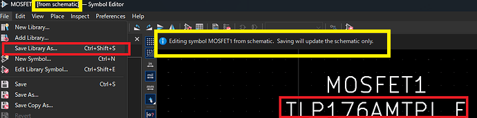

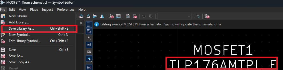

2.1. Edit the symbol using the symbol editor called from the schematic editor.
2.2. The symbol edits are saved to the .kicad_sch file (not the .kicad_sym file in the symbol library), which is the target of the schematic editor.
3.1. Edit the component using the symbol editor called from the schematic editor. The edits are the footprint library path information displayed in the symbol editor’s properties.
3.2. Next, continue as above and save the symbol by specifying a symbol file name from the symbol editor’s menu. (Are edits saved to .kicad_sch or a new symbol library file (.kicad_sym)?)
4.1. In point 3 above, we edited the footprint path information, a symbol property, from the schematic editor. However, if we launch the symbol editor from the project manager and edit and save the symbol file directly without going through the schematic editor, where will the edited information be saved?
4.2. While the above explains the relationship between the schematic editor and symbol editor, users should be aware that a similar relationship exists between the board editor and footprint editor.
Aside from visually checking the differences between text files (.kicad_sch, .kicad_sym, .kicad_mod, etc.) before and after each operation phase using a different tool and inferring the operation specifications, is there any way to confirm operation details not described in the official documentation? For example, you could ask a question on the forum, search past questions, or check the source code.

Possible UI improvements would be for the symbol editor to hide operation menu items depending on where it’s called from, or change the operation names to make them easier to understand.
For example, a symbol editor called from a schematic editor could hide the operation to save a symbol library, or when saving, add a pop-up warning that the edits will only be saved to attributes placed on that specific schematic.

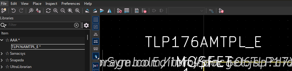

Is there a way to move a pin or name text from the pin connection in the ‘symbol editor’?
draw_pin_icon
I like to move the text more out of the way.
File → Symbol Properties > “pin test option”

This doesn’t move only the ‘pin name’ but the whole pin drawing with the name and pin number.
Remember I am using MacOS, maybe it works under windows, but not here.
Does it works for you?
Also I didn’t try any other symbols and footprints. I did recreate or repair what i have now.
