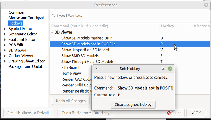

In: … / Preferences / Preferences / Hotkeys you also have an overview of all hotkeys directly in KiCad itself. And you can search though them, sort by different columns and of course also assign key combinations to functions that don’t have a hotkey assigned yet. I don’t really understand why putting these hotkeys into some other file format would be advantageous.

This is a a case of YMMV, but you can edit hot keys, or add hotkeys to unassigned slots inside KiCad. Just double click on one of the entries.

Double click where to edit? I’ve been trying in the “Hotkey list” window (after entering a term to filter on) - and while I can select “Flip Board View” under “PCB Editor”, no amount of double-clicking, right-clicking, or whatever seems to bring up an editor, and most of my internet searching brings me to THIS PAGE when I search for “Kicad edit hotkey” (or other, even less useful pages). My only options in the Hotkey List window are to filter terms (necessary to get anything useful at all), single-clicking (which highlights one row but seems to have no other effect), or hitting “OK” which just closes the window.
I’m sure there’s a simple way to do it - but it sure isn’t intuitive. In case it matters, I’m using KiCad 9.0.4 on a Mac.

Following up to myself - apparently, it’s in “settings”->Hotkeys - the “hotkey list” is just that (and also kind-of useless, given that it’s not changeable)

Yes, I posted that two months ago, but for me it’s Preferences, not Settings. You may find my advise useless too, but you can try to double click on one of the existing key assignments in the table.
For me this pops up a dialog with a question to assign a new key.
