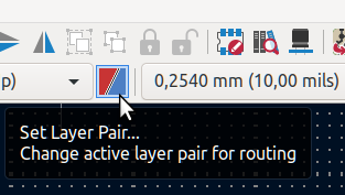

I would like to pre-defnie the blind and buried via how I can do that. For sure to understand when I traces the routing I would like to drop de via buried or blind and continus the routing
With the icon below, you can set the Layer Pair, which is used to determine between which layers you switch when you place a via. (The colors here are from the layers, so yours may be different, and change when you change the layers).

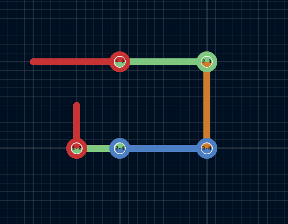

There is also a hotkey (Shift + Alt + V) which places blind or buried vias as tracks are laid.
ksnip_20250829-024724
Annular rings between the connected layers have to be removed later with edits, if required.
Layer pairs are in v9:
