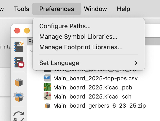

The default libraries are stored in the KiCad bundle:
/…/KiCad.app/Contents/SharedSupport/symbols/
/…/KiCad.app/Contents/SharedSupport/footprints/
Check the “Preferences” menu:
