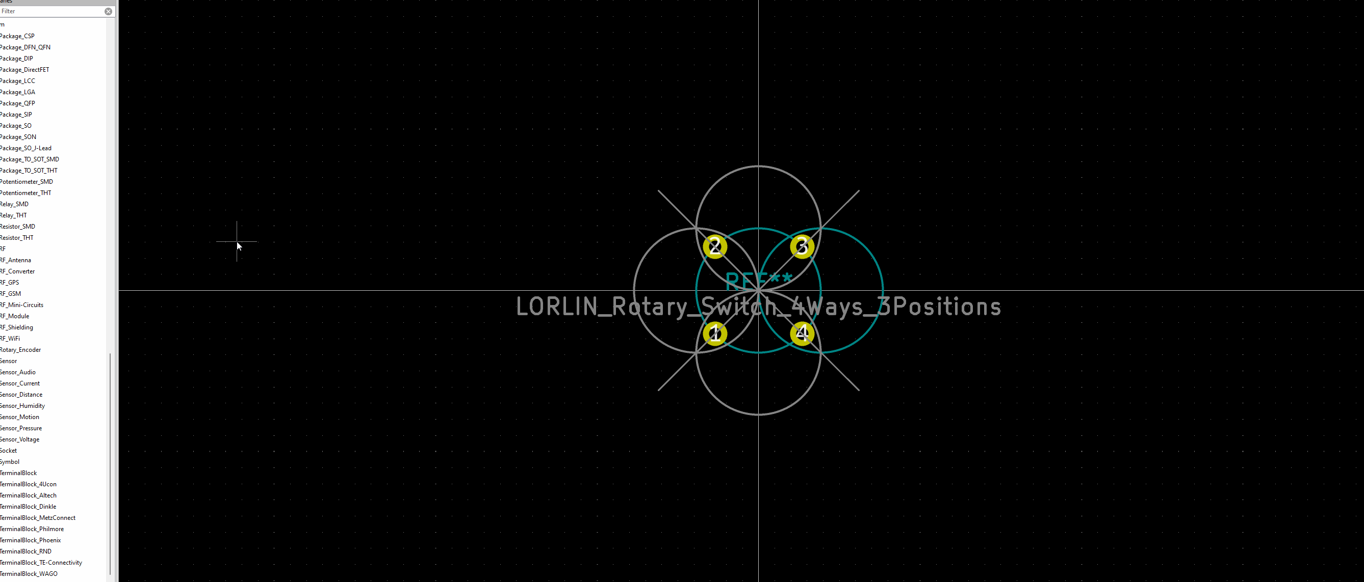

I’m designing the footprint of LORLIN rotary switch: 4 ways 3 positions.
I’m drafting the construction lines for the correct positioning of the elements.
I drafted circles radius 3.85mm and one of them is positioned on X axis at 3.85 as well.
But KiCAD thinks that it has radius 0 while it isn’t.
The radius is 3.85mm ON TOP of the 3.85mm positioned on X axis.
Please check the animated GIF here below
Where am I wrong?
I added into the tile and text. It’s the 6.0.0

I’m a little sloppy today. I tested this in pcbnew and I could not confirm.
Now I tested it in the footprint editor: bug confirmed.
It’s only the cirlcle to the right. And any radius. I tested 4 and 5 mm, same error.
circles to the N, W, S work ok.
So this seems to be a bug worth of being filed in the bug tracker.
I can confirm for (6.0.0-rc2-14-ga17a58203b) and for nightly (6.99.0).
reproduces for every case where:
y = 0.0
x > 0
radius == x
Confirmed for 6.0.0 release build as well

I did it. Now let’s whait the 2023 for the version v7.0

If someone reported the bug already in Gitlab, please do post the link here to follow up. Thanks.
EDIT: Fount it in Gitlab , has been fixed already (2h from report to fix! great KiCad team !!!)
