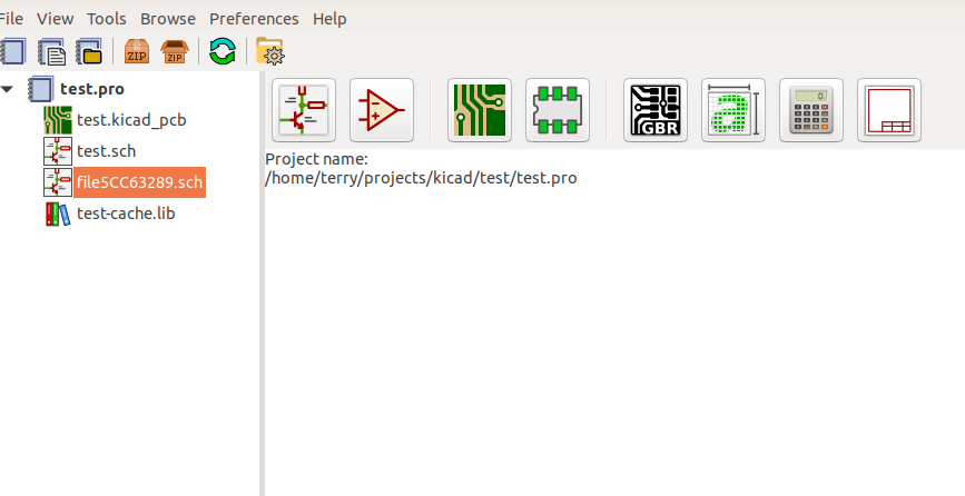

Sorry, my original post was not very clear:
The following steps demonstrate the issue:
  1. Create a new project.
  2. Open the new project schematic.
  3. Place a hierarchical sheet and save and close the schematic.
With version 5 the hierarchical sheet shows up in the left pane of the
project window as in the screenshot below. This differs from the
behaviour in version 4, which did not display hierarchical sub-sheets in
the left pane.
This appears to be because in V5 EEscehma creates the hierarchical
sheet with the first value on the ‘Sheet’ line set to 1. In V4 it is set
to 2. I can restore the V4 behaviour by editing the hierarchical sheet
file in a text editor to set this value to 2.
I think the V4 behaviour is preferable.
So my question was is the behaviour change from V4 intentional, or is it
a bug? and:
is there any option to restore the V4 behaviour other than editing the
schematic file to change the value in the ‘Sheet’ line ?
They display on the left until they have some content. A useful reminder that something is not done yet
Thank you. This is indeed correct, when I place some content in the hierarchical sheet and save it, it does disappear from the left pane. I agree this is actually a handy feature.
However, the first time I tried this I tried to add content to the hierarchical sheet by copying and pasting from a hierarchical sheet in another project. In this case the hierarchical sheet icon disappeared from the left pane, but an additional project file for the hierarchical sheet appeared in its place (screenshot attached). So it appears there is some anomalous behaviour if you populate the hierarchical sheet by pasting content from another project.Screenshot%20from%202019-04-29%2014-47-59
Additional note to my previous post:
I have also deleted the items I placed on the hierarchical sheet and successfully cut and pasted the content from another project into it without any side effects, so the work around is to make sure you take the following steps if you intend to populate a new hierarchical sub-sheet by cutting and pasting:
  1. place at least one component on the sub-sheet manually.
  2. Save the sheet.
  3. reopen the sheet, delete the component and paste the desired content.
