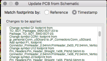

To get your project back to a usable state you could use “by timestamp” in the netlist import or in the update pcb from schematic tool.
The behavior you experienced is not expected so you could raise a bug report if there does not already exist one that reports the same thing.

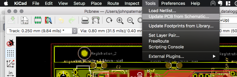

thanks for the response. I haven’t heard of the “update PCB from schematic” tool - where is that? Timestamp import doesn’t seem to help.
Here (on macOS at least) - I presume all other OS variants have the same menu structure.

absolute lifesaver. thank you both!
