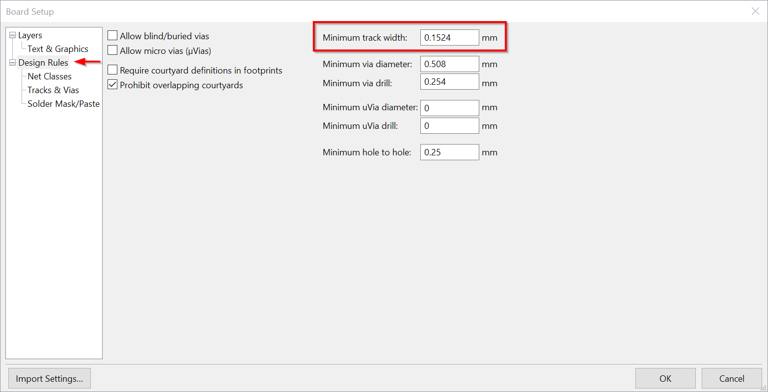

I am using Kicad version 5.1.0 and I would like to change the track width to 0.15 mm for my design. But, It says “Track width less than minimum track width(0.2mm).” I know there is a way to change it under Global Design Rule section on Kicad version 5.0. I guess it is missing in Kicad version 5.1.0.
Look at:
File /Board Setup / Design Rules
Like @JohnRob says, look here:
It can be easy to miss if you aren’t thinking that the top level of the board setup tree is anything more than organizing the “leafs” below.
