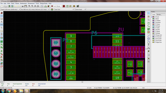

Here Three file attach 1.Canvas as OpenGL 2.Default mode and 3.Gerber file
We design PCB edge using Canvas OpenGL mode shown in fig canvas as OpenGL after make edge complete check Spectra DSN no arror after generate gerber and show it there are some change in PCB edge shown in Figure gerber file indicate by circle.

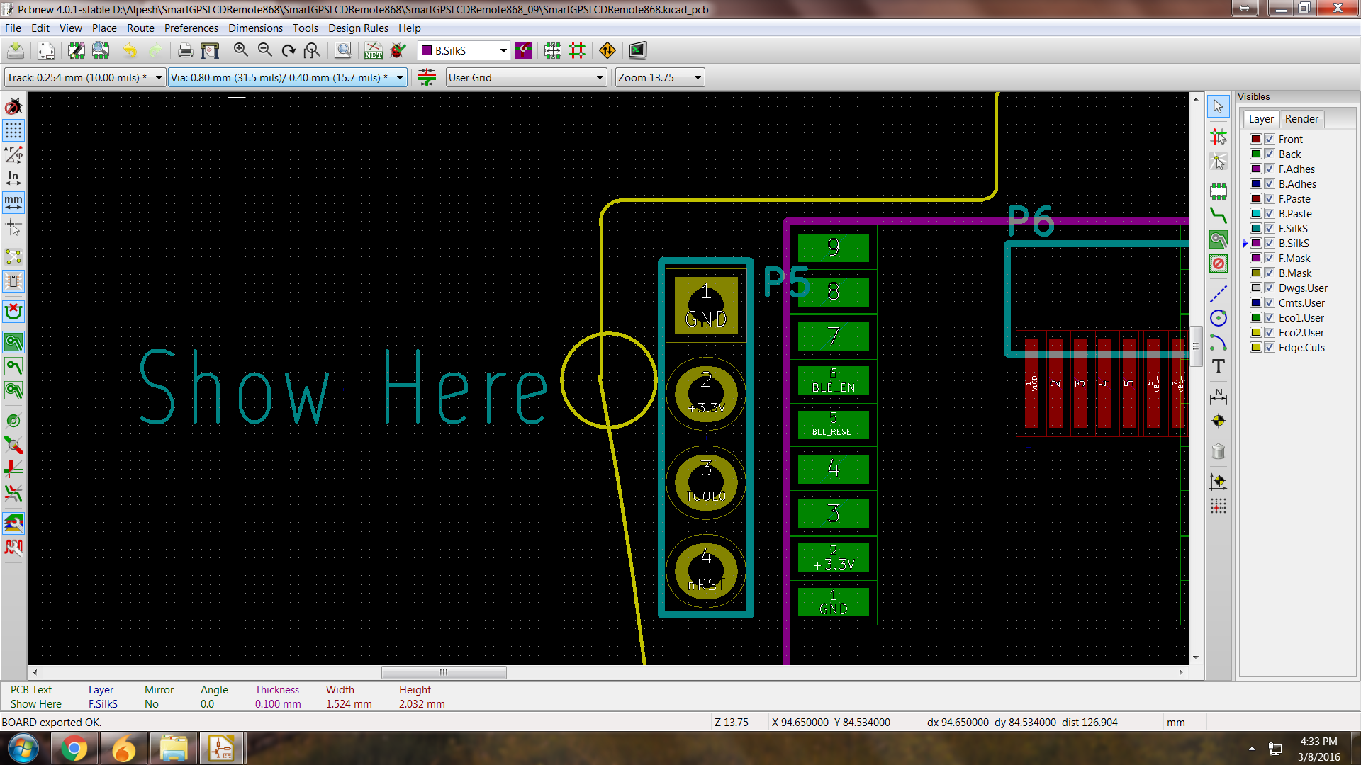

how its change in garbar its complete connection in OpenGL…
After i try to design change in Default mode just click view Canvas to default same edge problem shown in Default mode image and also shock while check Spectra DSN no error but pcb edge not proper connect so why not receive any error in default mode…??
If you right-click Select and go to Properties for each of the two lines that make that intersection, do they show a matching Start/End X-Y point? Sometimes when I have a curve connecting to a line at an odd angle, I have to manually edit one end point to force them to match. This is due to the odd angle not being an integer of the X-Y grid size. I do get an error thrown in this case however, before generating Gerbers, where you did not.
