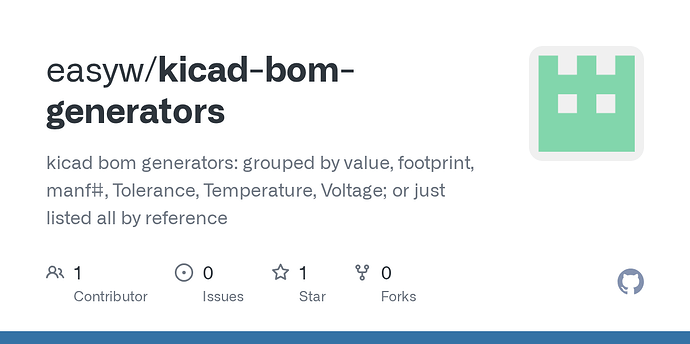

Before using KiBOM I was using a script that grouped the elements only if these fields were matching:
Manf#, Voltage, Tolerance, Power, Temperature, Current
In case of blank fields, the element were inserted in a different group…
I would consider useful the ability to configure some extra grouping fields.
Thanks
Maurice
not really…
these are my very first scripts I’ve done in python, just before starting coding for kicad StepUp…
Generate a comma delimited list (csv file type).
Components are sorted by ref and grouped by
  Value Footprint  Voltage Tolerance Temp Current
  Fields are (if exist)
        'Ref', 'Qnty', 'Value', 'Footprint',
        'Manf#', 'Voltage', 'Tolerance', 'Power', 'Temp', 'Current', 'Description'
version 3.3 - 06.2016  [bom_grouped_v33_ky.py]
If I found some missing fields, I just update the schematic and rerun the scripts
in many cases (i.e. resistors and capacitors) manufacturer number is not necessary, I prefer having a larger choice for some bare components … In same case the best is price, in other the availability or minimum number requested … that may depend on which type of production I’m going to have…
for ICs normally I have Manf# as a mandatory field
So that is why I use those other info on BOM and I think they are useful
