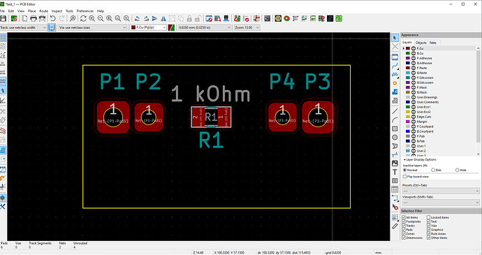

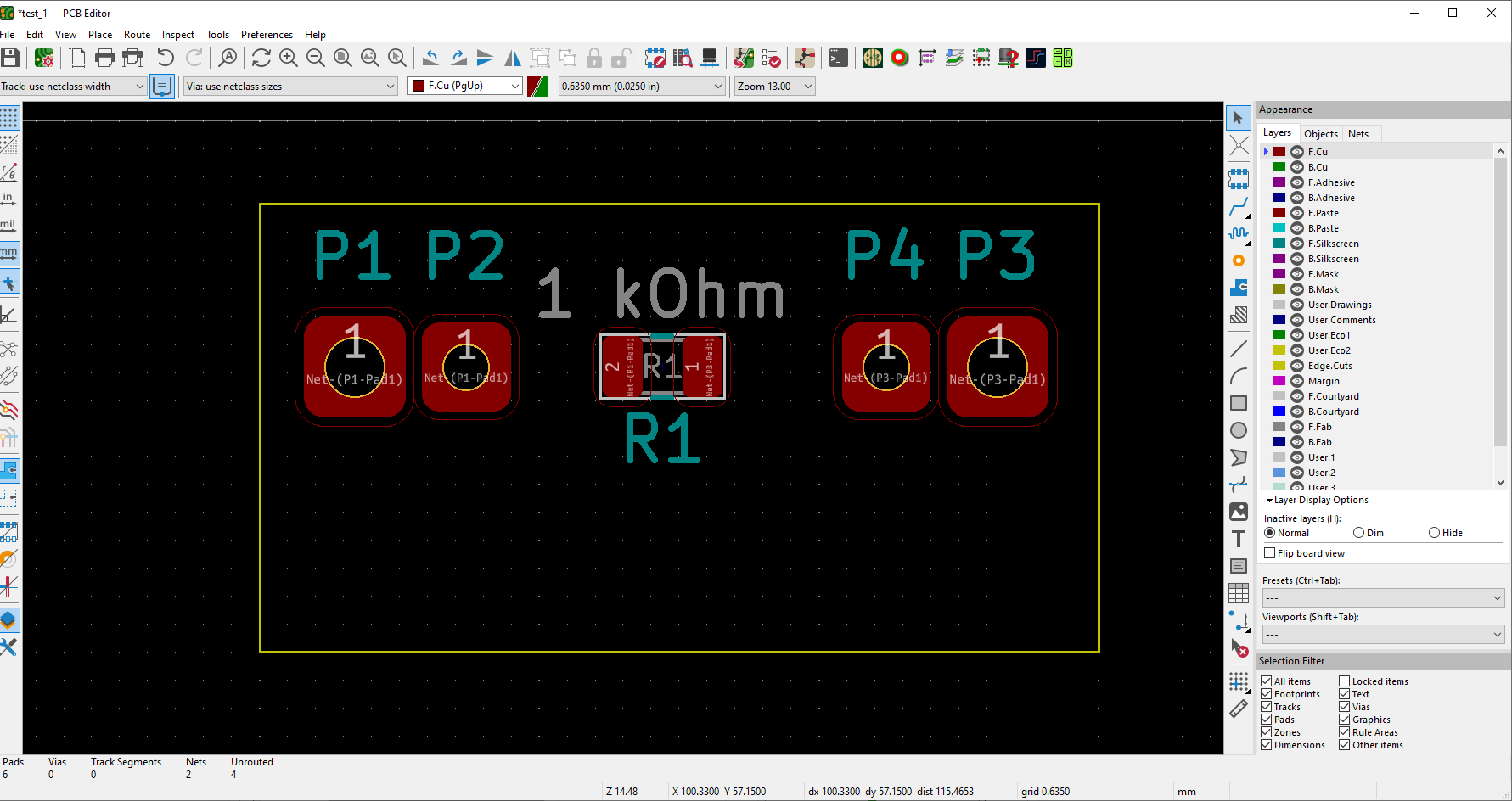

I can’t route the trace.
When I route from P1 to P2 or from P2 to the resistor, the program crashes.
If I route from the resistor to P2, everything is fine.
I don’t understand why, what am I doing wrong?

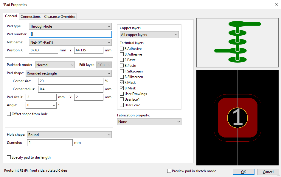

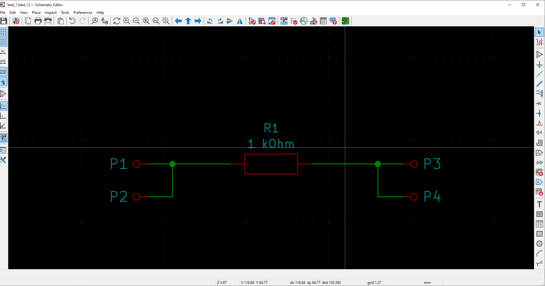

This is the contact pad for footprints P2 and P4.
P1 and P3 are similar footprints, only slightly larger than the hole and contact pad.

I checked again. When starting tracing from any of the P1, P2, P3, or P4 points, the program crashes.

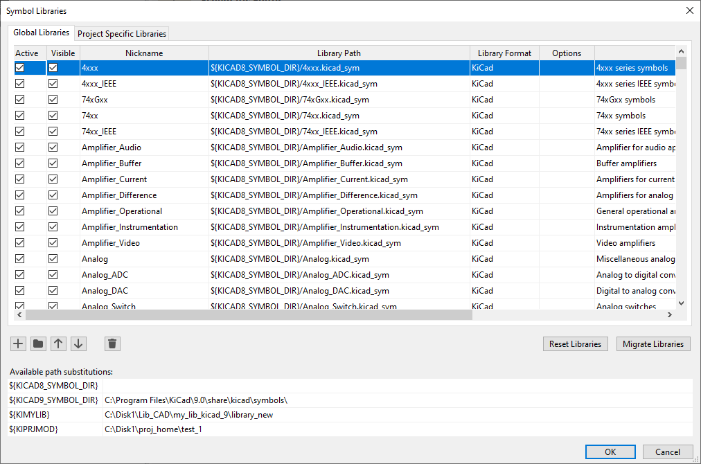

I noticed the library paths in version 9: for some reason, version 8 is listed. However, when I open the path to any library separately, it addresses the library version 9.
Could this be the cause?
I uninstalled it. There were problems during uninstallation. It’s possible I installed it for a single user. I reinstalled everything to default, without transferring the settings from version 8. It started working properly.
