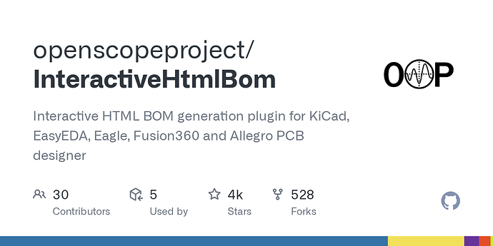

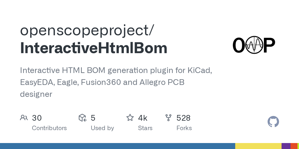

Any idea why is not working ? What have you tried ?
Take a look a this guide for the InteractiveHTMLBom, the preface applies to all plugins:
The topic arises frequently here are a couple of pointers:
I could not find a FAQ link at the moment, but If you want we can help you set the plugins up, it may be a bit of work at the beginning but the are a couple of gems well worth it.
