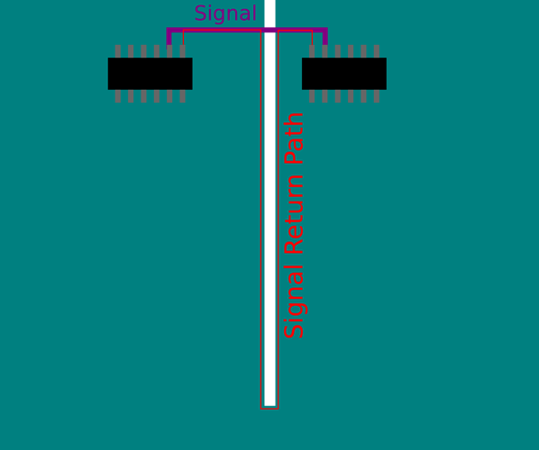

In a two layer board one really always needs to check that the ground plane is not interrupted below a fast (or critical) signal. (To avoid creating slot antennas. If it is interrupted where you cross then you need to give an alternative path for the “ground” on the top layer. Meaning stitching together bottom and top layer planes to get as close to a uninterrupted plane as possible.)

Avoid situations like these (a trace in the middle of the ground plane will split it into two islands. If you have a trace on another layer crossing that split you can end up with a nice slot antenna):
Disclaimer: this picture was drawn to show the same problem but with a different route cause (split power planes, badly made star points) The result with a split because of a trace on that layer is similar enough for this to be a good enough picture.

I now see clearly what is the problem, so thanks for the picture and description… At home I already added ground on the upper side, so that might help maybe. But for the rest I don’t see much options to solve this problem (if I have them at all, need to check that). I could throw in some via’s to interrupt a long trace line, or move the trace via a longer route away from the ground ’ island crossing’.
