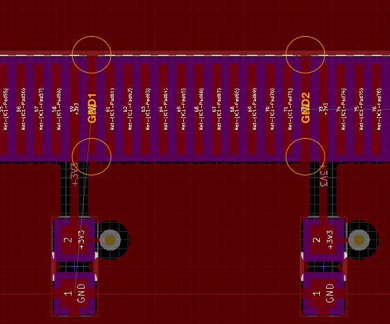

I have noticed something odd in the way Kicad is pouring copper and interpreting the nets. In the attached image, I am showing 2 different grounds. They are labeled GND1 and GND2 only for explanation, they belong to the same net GND. I have poured copper on the whole board, and you can see that the ground pads of the decoupling capacitors are seen as grounds, and linked to the ground plane through thermals.
One of the CPU grounds (GND2) has been linked on both sides, but not the other, although the geometry is exactly the same (pads spacing, wire width, etc…).
  1. Why is it so? I think it should be treated the same way, both pads should be linked on both sides.
  2. Why is there a ratsnet? The capacitor groundpads are linked together and the second one on GND2 has no ratsnet.

Have a look at the min with and clearance setting of the zone.
(Zones do not use the global settings defined for tracks.)
It might be that the connection between the pads and the bottom gnd plane is only just possible. In that case a rounding error can be enough to make problems.

I reply to my own question, I found something interesting. I cannot edit the characteristics of one copper pour area. However, if I set the features before drawing it, then they are taken into account. I deleted the copper pour, and drew it again, and it works. No unconnected grounds issues anymore. By the way, it might be unrelated, but I found the trick after “upgrading” to a night build to version 5. As I’m not sure it’s easy to reinstall 4.0.7, I will leave it as is. I simply hope the line grid of the opengl canvas will be restored soon because the dots ares imply invisible.
