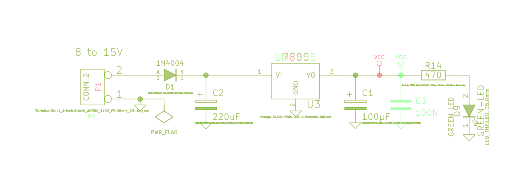

I have created a repo of a small python tool I use for a simple visual comparing schematics:
you need to manually plot your schematics as bw svg and then the tool will produce a visual red/green XOR comparison
