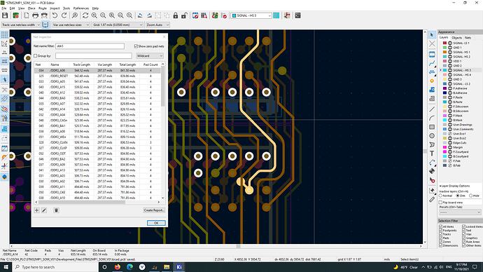

Is length matching in 5.99 broken or am i doing something wrong
So, i am trying to length tune some DDR3 traces, but KiCad can’t seem to measure the lengths correctly
On the screenshots below you can see that the trace length information provided by the “Net inspector” tool, “the tooltip” when using the length matching tool and the bar at the bottom when a trace is highlighted don’t match. After setting up the length tune tool to either one of those lengths, and using it, the finished length is of random length.
Here is the second photo
https://imgur.com/a/sJbIoqA
Can you please file an issue with your project attached so we can investigate?
Is the project going to be public or visible just to the developers?
There is a “confidential issue” toggle when you open the issue that you can use to keep your design private to just the devs.
