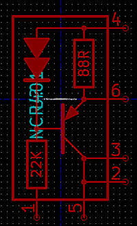

Symbols can only represent footprints or modules (pre-assembled pcbs) and can give you a clue about their inner workings like so:
