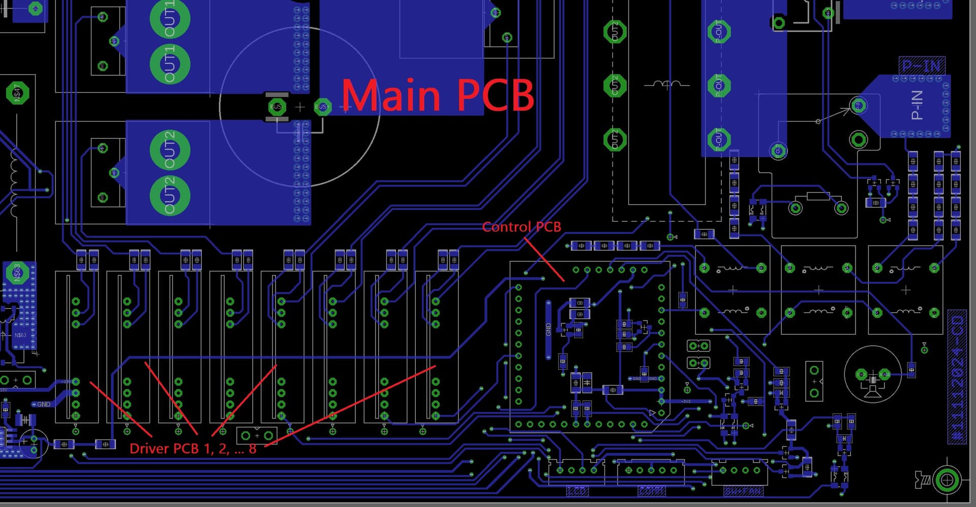

Actually when working with many projects I came across this requirement. For example our inverter PCB have a main PCB. In the main PCB there are 6 driver PCBs, one control PCB. So under this project I need to create a main PCB (and many versions of this: main PCB1, main PCB2…). Then I need to make a driver PCB (again many versions driver PCB1, driver PCB2…). Similarly for the control PCB. A finished PCB will look something like this:
There is nothing wrong or difficult for making separate KiCad projects for the “Driver PCB” and the “Control PCB”. Then also make footprints for these PCB’s and add them to the “Main PCB”.
You can also make 3D model for your control PCB to see it when looking at your main PCB 3D view.
Yes. It is not impossible to create seperate project for each schematic-PCB pair. But if you have 3 versions of main PCB, 5 versions of driver PCB and 4 versions of control PCB then you will gave 3+5+4 = 12 projects. I think that is very annoying.

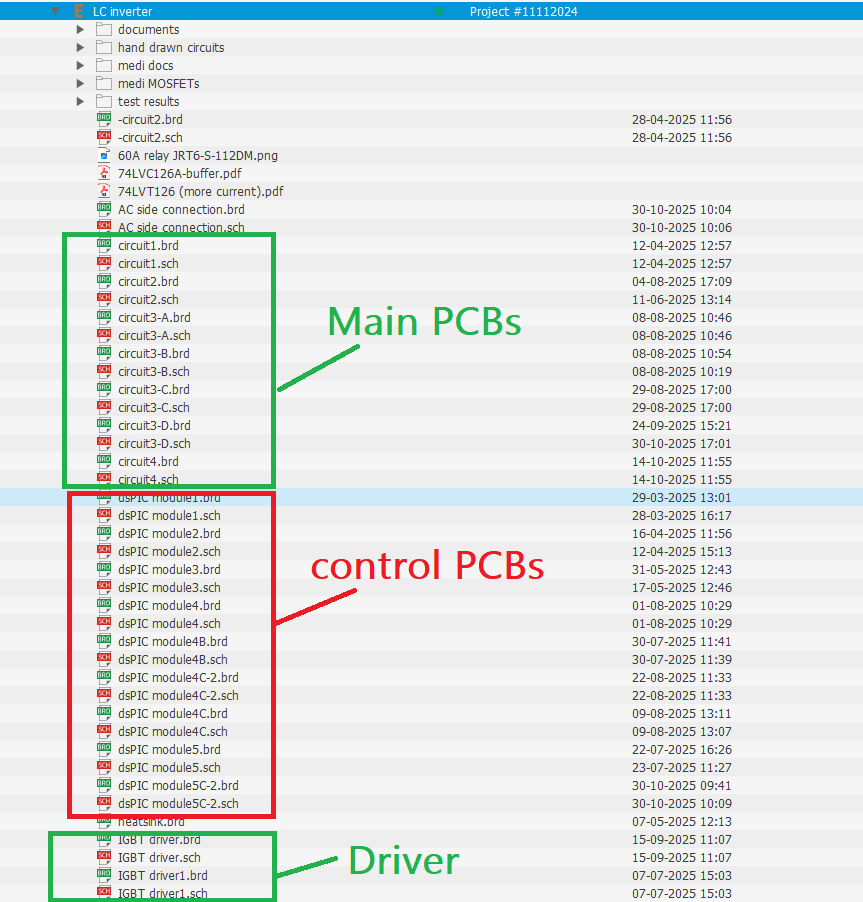

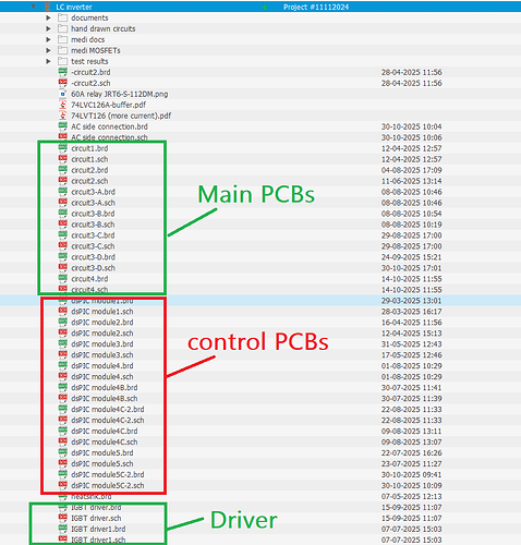

I am attaching a screen shot of PCB and schematic files under a project in Eagle:
The only difference is the organization. Both, eagle&kicad, don’t really support multi-pcb assembling. (unlike the newest eagle/fusion development have added that feature, I stopped with eagle v7.7.ultimate) with netlist/DRC across multiple pcb.
The eagle project manager just allows to add multiple pcb/schematics to the project tree.
In kicad you will have to do this manually: Norton commander–>create a suitable directory structure:

The kicad project explorer doesn’t shows the other subsprojects, but for this task the OS file manager (or any other file manager) can be used.
