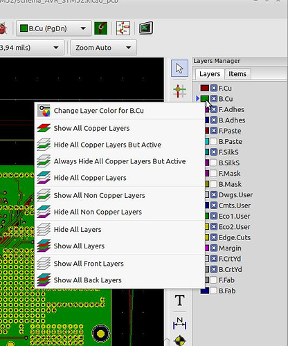

Have you tried the “High Contrast” mode (Ctrl-H) ?
KiCad_hi_contrast
If you right click in the “Layers Manager” on the other side of the screen, you can change the colors of the layers, and also set the opacity of layers.
For me an opacity of around 80% seems to be a usable compromise.
