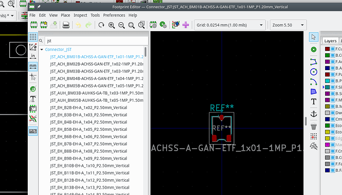

Where do I find simple things - like JST connectors or Dupont headers? I have been using the generic connector, 1X, but am not sure if this is the right thing?
Thanks for your fast response.
The generic is fine for the schematic symbol. You then choose a footprint to go with it. I see JST in the footprint editor as a selection. I think the Dupont are pin headers. You just need to know the spacing.
I wasn’t able to find JST, either by search or filter. Possible that I don’t have something installed? Or maybe can you show the full name string? Thanks again…
Remember, this is a footprint to be paired with the symbol. Something like a 2 pin connector can have dozens of footprints that could be associated with it. What OS are you using? It could be a packaging problem. Shouldn’t be though. I think everyone just uses the libraries ‘as is’ provided by the Kicad team.
Dang, can’t find that. I’m using Windows 10. Can’t find anything that resembles a pin header, either. It must be a missing install component, because that should be a core object.
One quirk as I recall is you have to add libraries ‘per project’. It speeds us caching if you don’t use them all and no one needs them all. For hacks like me that don’t know stuff that well I just load them all.
The default footpint libraries include several of the form connector_pinheader_(pitch option)(mounting options)
Also note that Hermit posted a screenshot of the “Footprint Editor”.
That has a pretty nice search function for (sub) strings in footprints.
Thanks to everyone for chiming in. I uninstalled, and reinstalled. KiCad. I now can find everything that I’m looking for.
