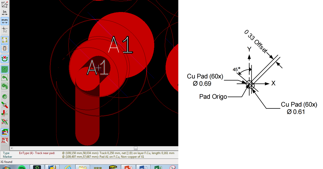

The project I am working on requires using irregular shape pads, consisting of two circles at a 45 degree angle (see second image, cannot post two pictures as a new user)
I got around it by making two pads, poth with the same pad name. But when I try to use it in PcbNew, I cannot connect to either part of the pin (see error below):
Is there a workaround?
Does it work with DRC off? May be clearance violation.
Did you assign a net?
You can’t start drawing tracks from ‘nowhere’ (= no NET assigned) as KiCAD won’t allow you to connect them to pads with NETS assigned with DRC enabled (standard).
You either have to start from a pad (normal usage) or disable DRC in the options (bad idea).
The
ErrType(4) - Track near pad:
message in your bottom left of the screenshot + that we can see the end of that test-track tells us that you tried to do just that.

Hi Rene,
That was the issue.
For my custom component I used “Pin Name” field instead of pin number. Will correct it ASAP, get back to you if it fixes the inital issue as well.
