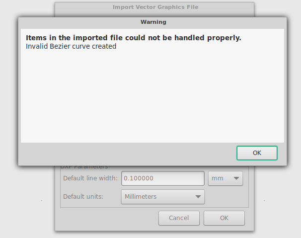

I created a board shape in LibreCAD, exported it as DXF and importing the shape into KiCAD fails with
Items in the imported file could not be handled properly.
Invalid Bezier curve created
Screenshot from 2022-03-16 14-02-34
The DXF outline is attached. Just importing this in an otherwise empty file triggers the message.

Both, and I guess Kicad takes the bigger share.
Try to save in an older dxf-format and than import into Kicad.
Attachement saved as DXF-R12-format in QCAD and imports without error-message into Kicad.
outline_v2_r12.dxf (22.2 KB)
The root-cause is that DXF is an ever changing/enhancing format. For instance QCAD (similar to librecad) alone offers me 7 different dxf-versions during file-save.
So I think your outline.dxf contains elements from a dxf-version newer than Kicad can import.
Ok, bug report: Importing DXF results in ā€œInvalid Bezier curveā€ (#11153) Ā· Issues Ā· KiCad / KiCad Source Code / kicad Ā· GitLab
LibreCAD has the option to save in R12 format and that works, indeed. Thank you for the hint and the quick reply.
