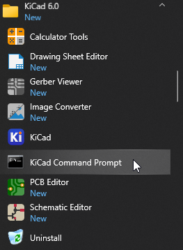

Here is an example for a Windows environment:
This opens the command prompt.
  • “pip install shapely” Execution result
  • KiCad 9.99 Command Prompt
You may now invoke python or pip targeting kicad’s install
%USERPROFILE%\Documents\kicad\9.99>pip install shapely
Defaulting to user installation because normal site-packages is not writeable Requirement already satisfied: shapely in %USERPROFILE%\Documents\kicad\9.99\3rdparty\python311\site-packages (2.1.1)
Requirement already satisfied: numpy>=1.21 in c:\program files\kicad\9.99\bin\lib\site-packages (from shapely) (2.3.1)

  • action
%USERPROFILE%\Documents\kicad\9.99>pip uninstall shapely
%USERPROFILE%\Documents\kicad\9.99>pip uninstall KiKit
%USERPROFILE%\Documents\kicad\9.99>pip install KiKit
When I started the plugin, a pop-up message appeared saying that the library being called was missing.
  • Further action
%USERPROFILE%\Documents\kicad\9.99>pip install matplotlib
The plugin started up using the above steps. This is my first time using this plugin, so I don’t have any experience with it or whether it works or not.
