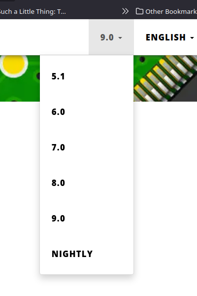

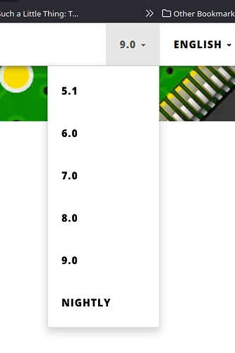

The docs for 5.1 are online, you just have to pick the version from the dropdown.
The instructions for importing a symbol from a file are in the eeschema documentation, and for footprints, in the pcbnew documentation. Before you do any imports, read jmk’s FAQ about personal library setup.
