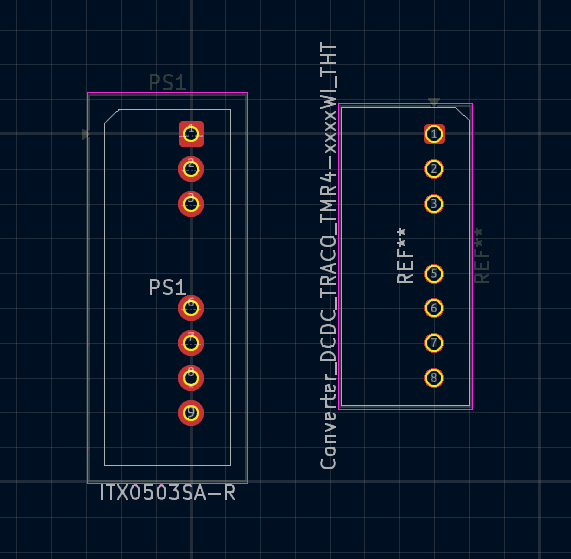

Not sure if this is the correct place to put this (maybe making a GitLab issue would be better?), but it appears that many of the ITX and ITQ DC/DC converter symbols in the default symbol library link to incorrect default footprint. Most incorrectly use the footprint for the IT series of DC/DC converters which has a slightly different pin spacing (The gap between sides is one pin too large).
All the effected symbols (as far as I can tell) are derived from the ITX0503SA-R, ITX0505S-R, and ITX0505S symbols so only these should need to be changed.
Anyway, a good lesson to always double check your footprints so you don’t end up having to order a new board like me :crazy_face:
It is better to raise an Issue on the GitLab tracker
Hi @gjurgiel
Confirming your observations.
ITX0503SA-R lists the above LH footprint, when, in fact, it should be something like the RH footprint.
