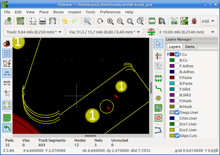

Hi kicad user,
i didn’t found how to improve the filling area border. Like in the screen shot. I would like more segment in the border to smooth the area border.
Is there an option for this in pcbnew ?

@eelik you can try to open the file. I upload two mod for this.
anode.kicad_pcb (161.6 KB) SAMTEC-FSI-105-06-L-D-board.kicad_mod (1.0 KB) disk_70mm.kicad_mod (463 Bytes)
EDIT: what I say isn’t correct, see my second EDIT below.
OK, I can see the problem is real. KiCad v5.1 fills it that way. The max distance between the zone fill edge and the pad clearance line is even 0.2mm. I think it’s because of the large radius of the circle. Somehow the margin is relative to the radius. Maybe normally there are no features with that large radius in KiCad designs so nobody has seen this as a problem.
Version 5.99 (the unstable development version leading to v6) works differently, there the margin is about 0.01mm throughout which shouldn’t be a problem.
EDIT: changing the zone’s clearance affects this. The zone clearance creates the 0.2mm distance. Play with the clearance (and maybe min. width) in the zone properties and see if it helps.

I noticed that in the 10 prongs, you used both NTPH pads and circles on Edge.Cuts. Here I moved a pad to make the circle visible:
DRC in KiCad does not like this much and complains about Board outline does not form a closed polygon
Oops, euhm… No, that is not it entirely.
On closer inspection it shows you have placed 4 complete board outlines on top of each other. In the screenshot below I moved a few:
So that’s two things you should also fix:
  1. Do not both use NPTH holes and circles on Edge.Cuts.
  2. Only use a single PCB outline.
