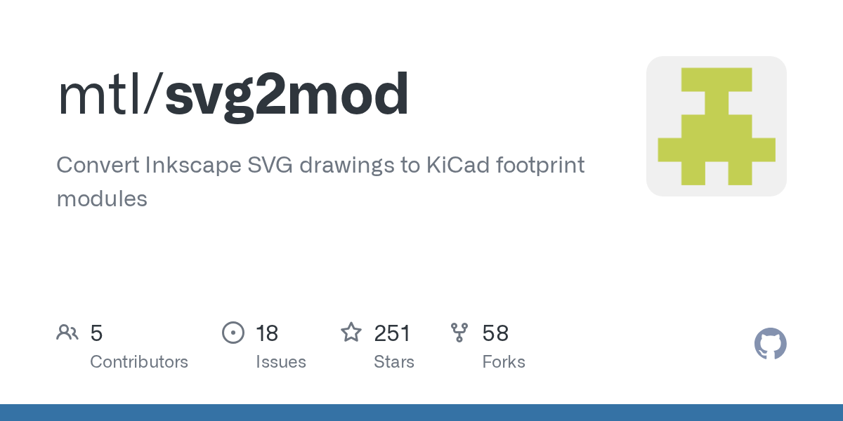

There is:
It creates polygones
It can make features on any layer (layername in inkscape defines layer name in kicad)
The tool is able to scale your drawing and you can select the precision. (how many points are used to approximate your drawing)

You could use inkscape to do that. (It’s open source)
But if you already use inkscape you could go the route of svg2mod. (This tool can put stuff on any layer you want and it can scale your result.)
(Just a suggestion for others and for you in future.)

So I tried Inkscape but I can hardly stand it on OSX, hdpi wasn’t working and the hole X11Quarts stuff is such a mess. It also can’t open this svg, it just hangs indefinitely. This is my svg, it’s pretty small:
I’m now instead trying to modify my svg with inkscape layer names according to this: Inkscape SVG vs. plain SVG - Inkscape Wiki
but I’m struggling.
Another approach would be to fork svg2mod to support my non-Inkscape use case. Just briefing the code, I understand that the underlying svg lib supports it fine and that it’s probably just a convenience with the layer mapping. I would be fine with just putting all paths on the layer I give command line (front silkscreen or bottom silkscreen). But I suck at python.
Yet another approach would be to try and find tools I’m more comfy with (node). Libs for parsing an svg there are tons of. Should be fine and the s-exp format is pretty simple. But I realize part of the whole thing is approximating bezier curves with multiple straight line segments which is part of that separate python svg lib. Should definitely be node libs around doing that too, but probably a bit of work digging for that…
