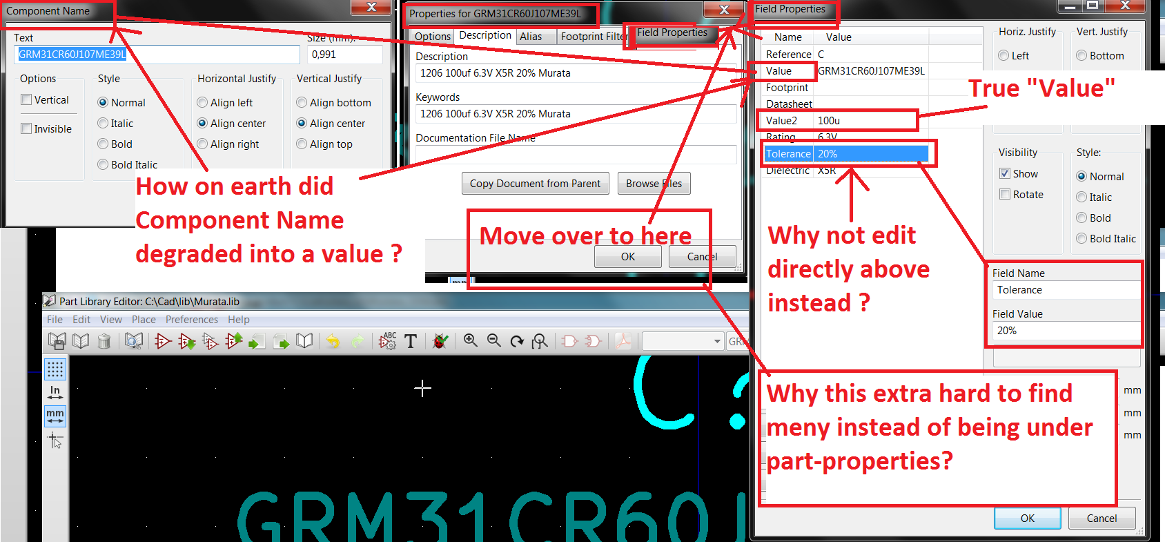

find my opinions summarized in this pic
For the question “Why not edit directly above instead?” the answer is very simple. Remaining controlls (check boxes, radio buttons, etc…) on the right have significant meaning during editing fields. The table on the left is only for showing entire fields.
IMO, this window layout is good enough.
Ok
and why did component name turn into a value ?
started of good as a component name as it should be.
Because it is unique…?
Every database need a ‘key’, an unique ‘key’. The symbol library is like a database.
Remember that KiCad did not show up yesterday. It evolves already pretty dozen years. On arose, some things were simplified by existed at all. There wasn’t an “army” of volunteers to write code. There wasn’t also a multitude of users, only the students of Mr. Jean-Pierre Charras.
Today KiCad has significant value in EDA world. So some things should be change to trample on the heels those with established position. But people doesn’t like revolutionary changes, so they must be introduced gradually. Eeschema and his library system is on the short list.

but it would not been any extra programming hours to stay with component name instead of value
also you open up the component properties tab/button but you dont get all the properties
there is a “T” button for another set of “text” properties
confusing for the newbie like me
maybe it has historical reasons and as you pointed out it dowsnt matter really once you figure it out.
but that could take some time
also i think that some more extra default fields could be standard just to point users in the right direction
manufacturer, “true value”, rating, tolerance
We have the gimmick field of datasheet, but not any other more normal/useful fields

now people make parts that have the component name 10K
not very useful
the software itself can point into a direction where the libraries will get better quality if it becomes more obvious what fields you should use for what.
