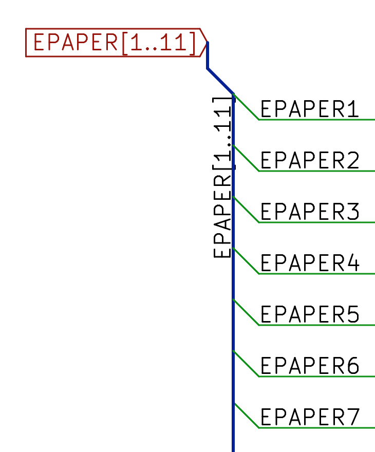

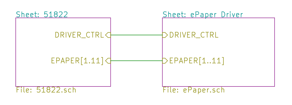

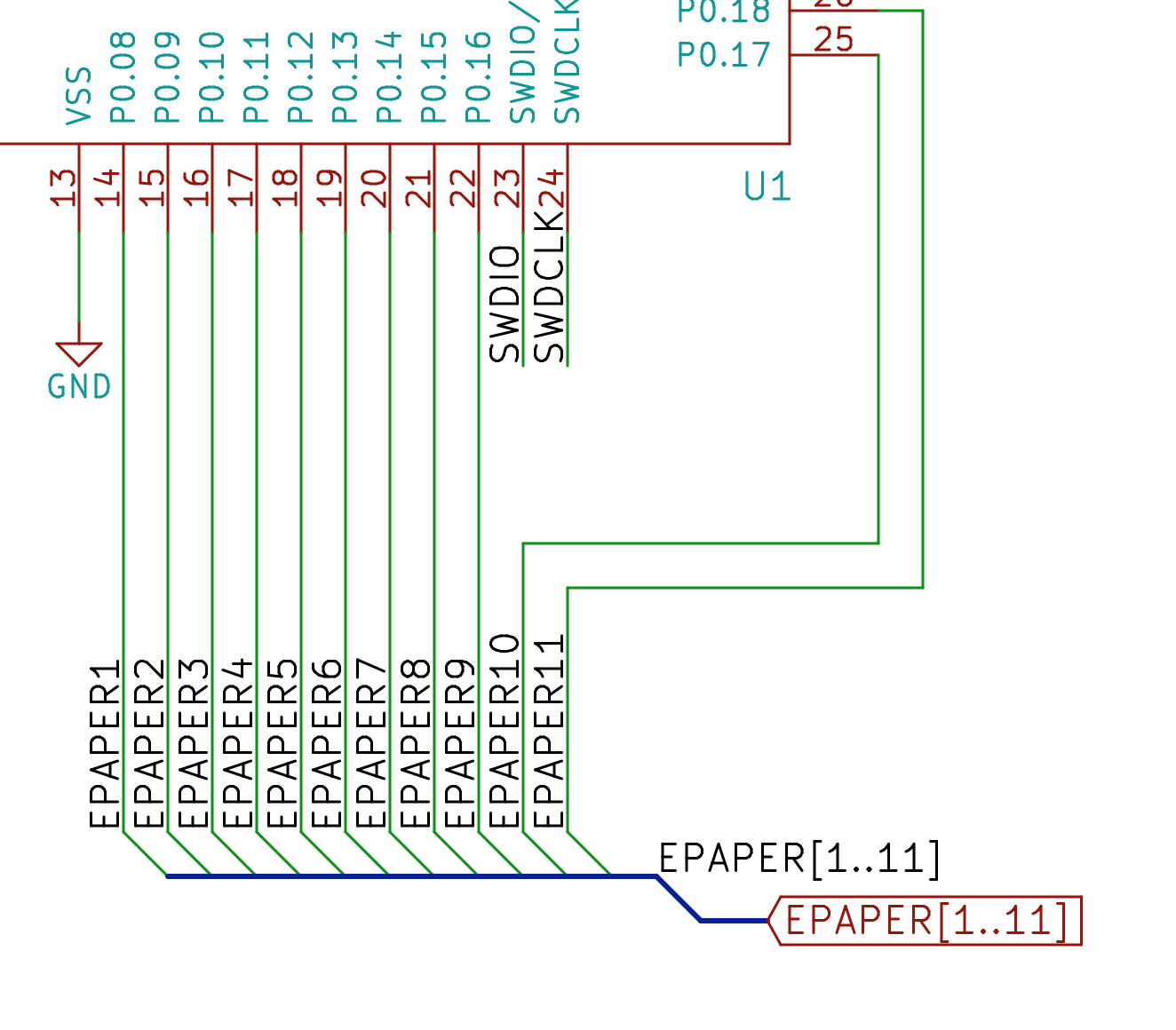

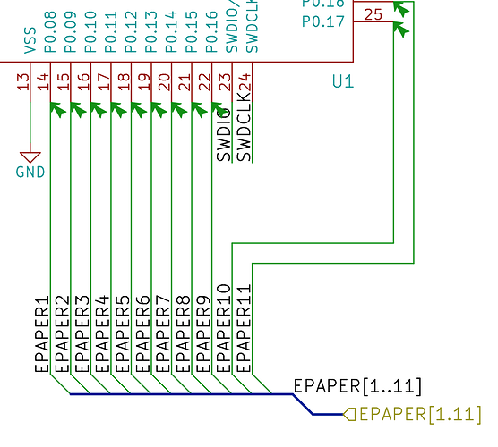

I want to connect buses between hierarchy sheets, but ERC reports it is not connected.
When I replaced hierarchy labels with global labels, it works
I’m using KiCad-4.0.2
here is my schematic:
(I’m a new member I can only post one image each time)

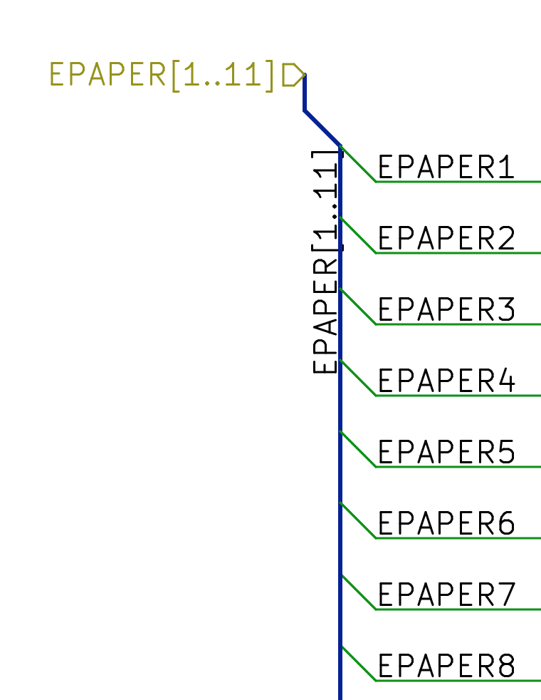

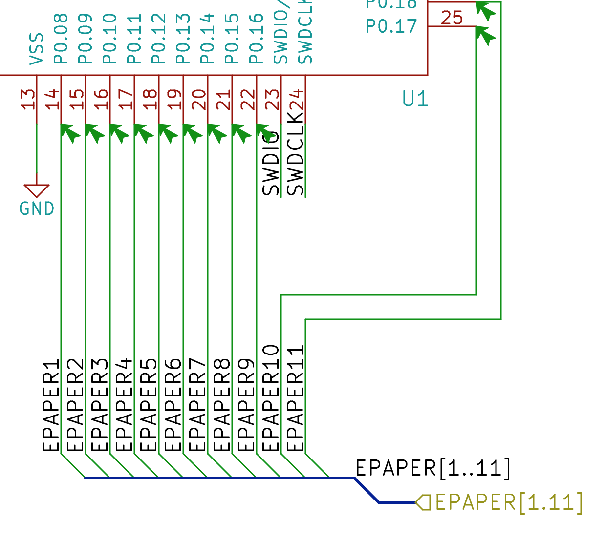

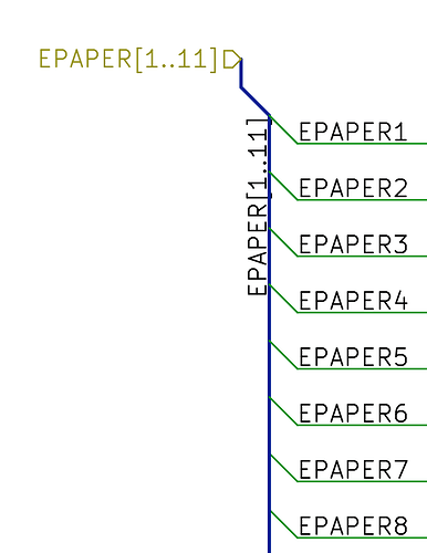

with hierarchy labels:
here it reported unconnected by ERC

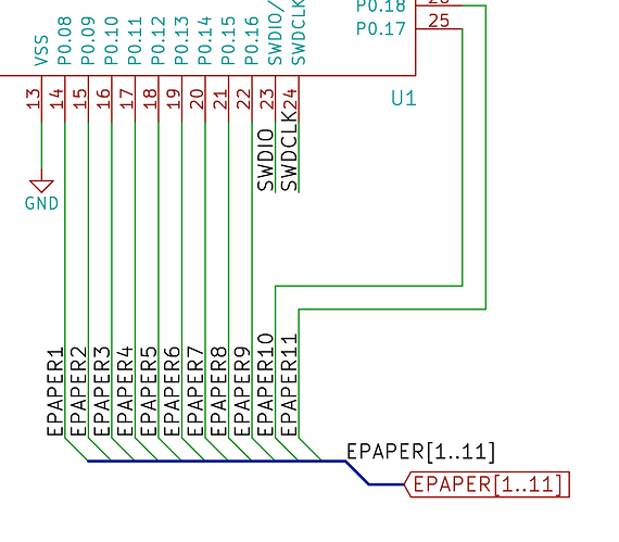

Then I replaced hierarchy labels with Global labels:
It then works
Is it a bug or something I was wrong

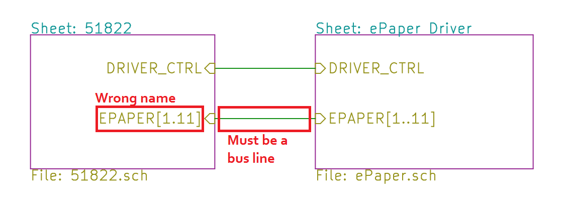

You have two issues on a start.
  1. Left sheet has wrong hierarchical pin name.
  2. You’ve been used normal wire instead of bus.
Oh Bus line… you are right :slight_smile:
