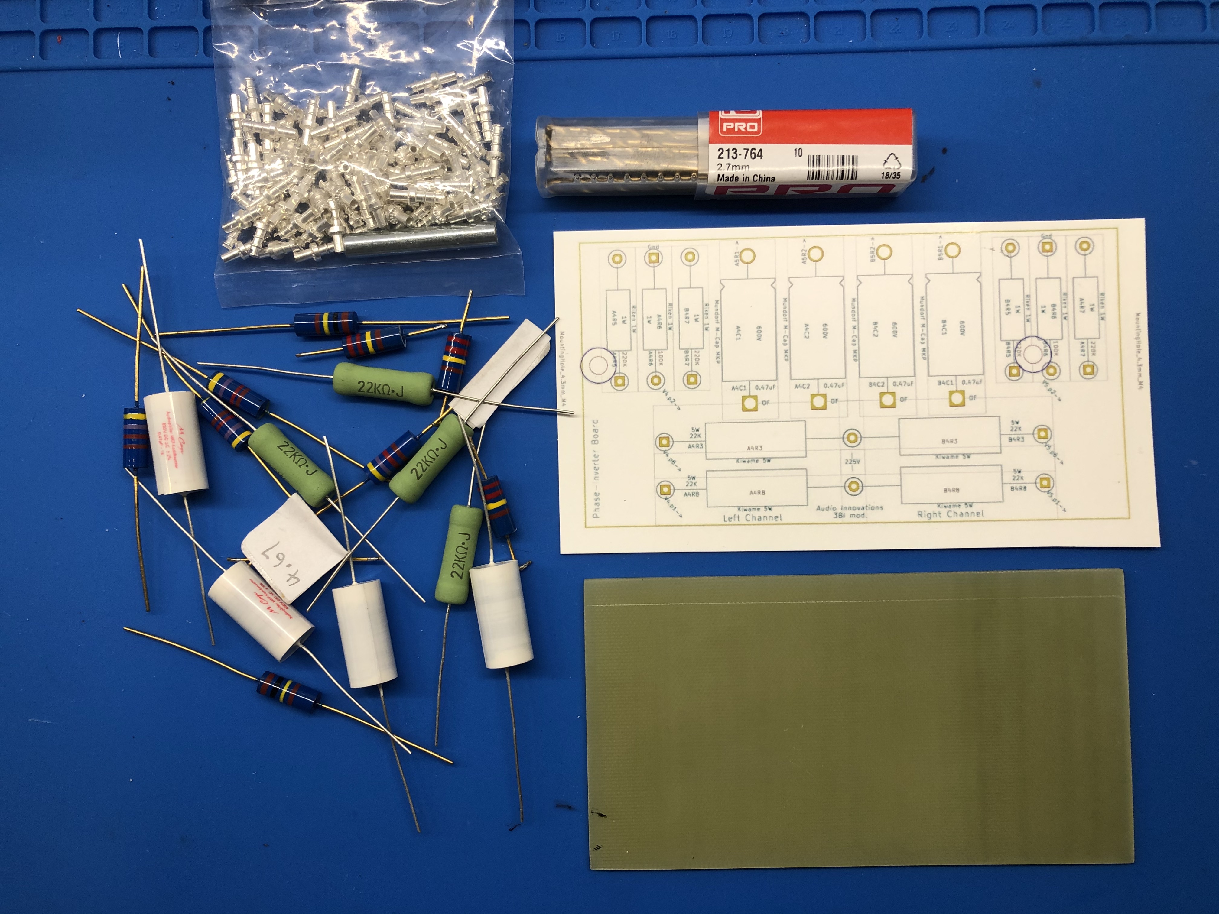

I have created a Schematic and a Board, using new Symbols and Footprints for the components that I am using, and I have printed a Decal for the Board. This is a prototype or one-off for now so I am doing everything myself. I will apply the Decal to the 4mm Glass Board and then drill the holes. I just hope the Decal film will not be affected by the engineering or the mounted components.
This project is a repair to an Audio Innovations series 500 HiFi amplifier. The Phase-Inverter Board is prone to be burnt out by under-sized resistors on these so I am building a new “enhanced” one. I found a bunch of Riken Ohm resistors, just the right size, in my stash so I am using those along with some good ordinary MCaps and 5W Kiwame carbon film resistors - the original resistors were 1W. I am using Turrets from RS.
Turrets are different from holes in that they can accept more than one component so, until I find a better solution, I have overlapped the Turrets for those power-supply resistors but it’s a fudge.
