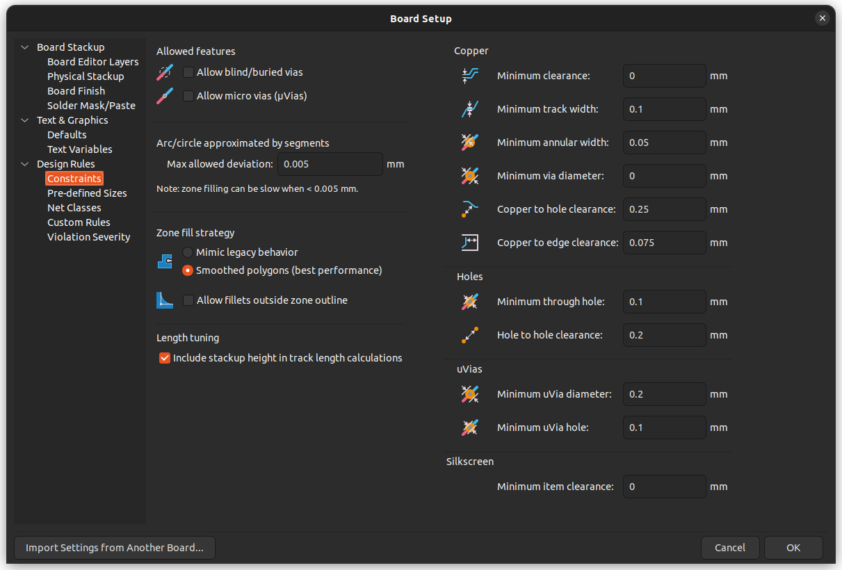

Thanks for sharing your settings. I still could not fix this.
Yeah the via is very small. The hole of 0.1 mm was during this test.
Now I could put the vias by increasing the Via Size to at least 0.42 mm. It does not work if it is smaller. It may be related with another dimension that I am not aware of.
These are my Board Setup > Constraints by the way
Now if the via is not DP, then it can have smaller sizes.
I found out that what was preventing me to place vias on this case was the copper to hole clearence Reducing this value I could place the well formed vias between pins
This settgins here.
Result
Now, i am not sure if ti is easy, but the DRC rule that is preventing me to place vias could be explicit in the line that says that DRC rule does not allow me to place the via. So it could have helped me to place those vias faster.
