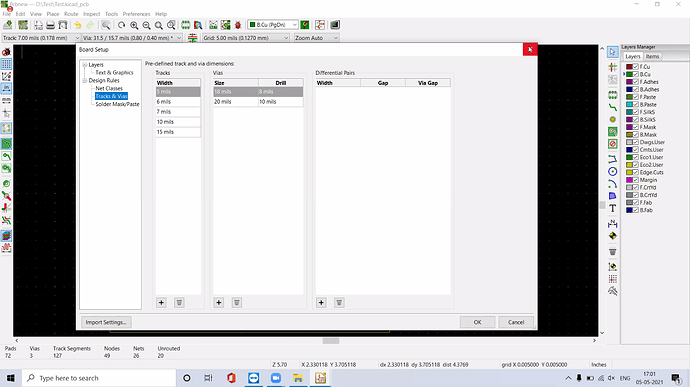

If you want to change all the vias in the board to a different size then you can specify the sizes of via in board setup.
Then, from Edit–> Edit tracks and via properties, uncheck all the filters and select the size and click ok.
If you want to change the via size in the same net, check the filter items by the net and select the size.
If you want to change the size of via in the particular class, check the filter items by net class and select the size.
