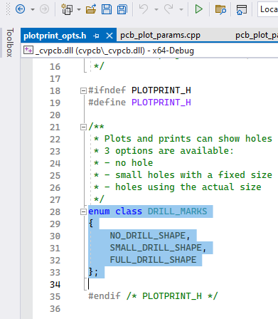

But it’s there:
devenv_bZy3U79xtj
Yes, but how do I use it in Python?

It will show up as <enum_name>_<value> e.g. pcbnew.DRILL_MARKS_FULL_DRILL_SHAPE
If it’s not there that means the nightly doesn’t have the fix yet.
Thank you! That I haven’t tried. I’ll test tomorrow.
That certainly did the trick! Thanks again!
