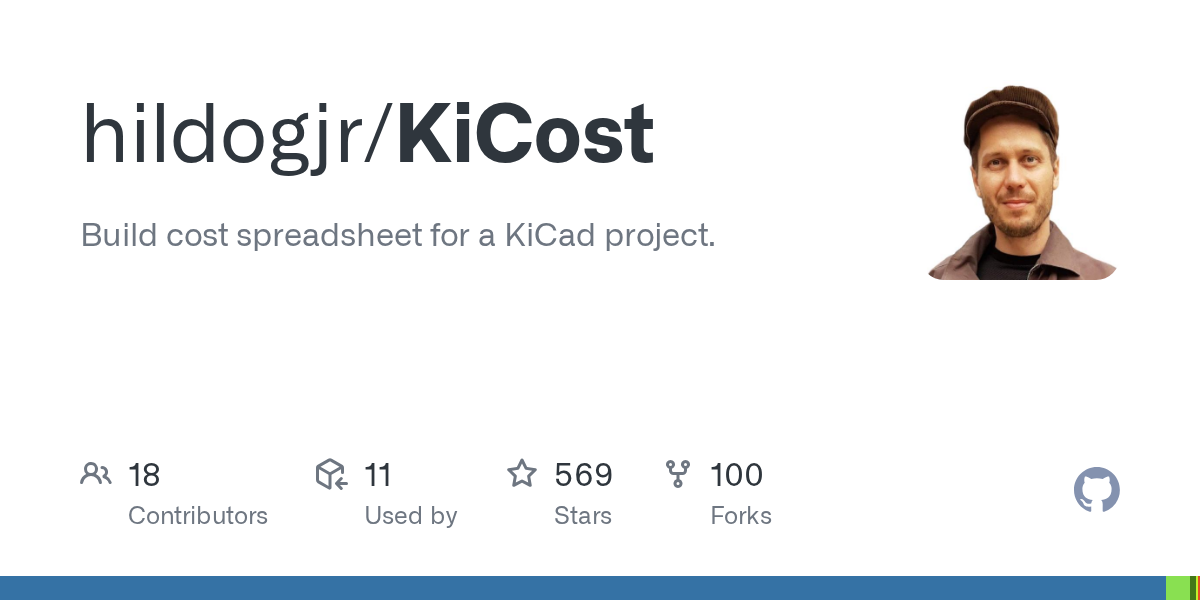

Maybe you are referring to KiCost:
or this for LCSC components:
I’ve used neither myself. I use KiCad’s libraries but do not trust them and verify items manually as part of the verification process just before finalizing and ordering PCB’s.

checking Kicost, I am not sure it will grab LCSC references from my csv , I’ll check this out
What I remember of KiCost (have not used it myself) is that it gets price information for items in a KiCad projects BOM and makes an overview of it, and one or 2 years ago most development stopped because of difficulties with getting (and maintaining) accurate price information. Apparently companies who sell parts do not like tools like this very much and they use tools that (constantly) modify their websites in subtle ways which are not visible to humans, but block automated scripts.
