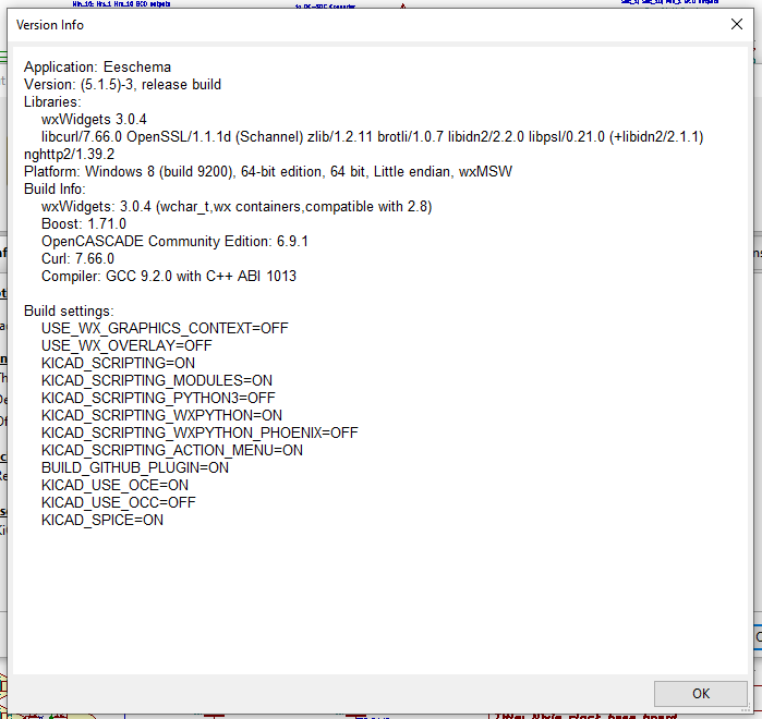

The KiCad version info is as follows:
Thanks for your advice in advance.

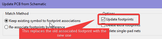

There’s no need to use a netlist (it’s an old way to do it). Use Tools->Update PCB from Schematic.
Simply change the symbol’s attached footprint in eeschema and update the PCB.
Delete it in pcbnew manually then place it again.
Make sure your custom footprint has a unique name / a library of its own. This will avoid conflicts in the future.
Caveat regarding the previous poster: this would update ALL footprints, changing modified texts (val / ref) etc. to default values, no?
This may create confusion in the readers. If you edit the footprint in the fp library, it’s enough to use the “Update Footprint from Library” functionality in pcbnew. However, if you change the fp association in the symbol, you have to update footprints while updating the PCB from schematic.
The “Update footprints” option in the “Update PCB from Schematic” dialog does not update all footprints in the board. It only replaces footprints which have been changed in the schematic symbols, i.e. where the footprint is completely different one in the library, with different ID.
EDIT: updating a footprint/footprints in the pcb using Update Footprint dialog reloads the footprint from the original library files.
The terminology of the UI is confusing. The word “update” shouldn’t be used with different meanings. In 5.99 the Update from Schematic dialog is better:

In this workflow you can open Tools->Update PCB from Schematic from either pcbnew or eeschema and update the board layout after making changes to the schematic. There’s no need for a netlist.
I still don’t know what you actually wanted to do because you told that you assigned a new footprint in the schematic but then succceed by using the Update Footprint functionality in pcbnew (without updating from the schematic?).
If you change the footprint association text here:
you have to use Update PCB from Schematic and “Update footprints” option there.
But if you edit the .kicad_mod footprint file and want the change to be reflected in the layout which already has that footprint, you have to use the Update Footprint(s) function in pcbnew on that footprint.
