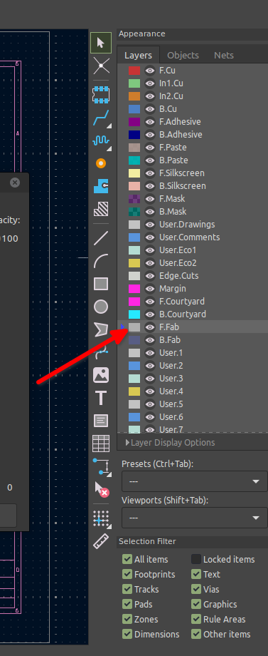

Is there a way to change the color of the component pin numbers and associated net descriptions? They seem to be fixed as white, which contrasts well with the default black background, and is still visible when they appear over colored tracks, but are not visible on my white background.
If the RH side of the PCB editor looks like the below (I can’t remember what 7 looks like), click on the color sample for the F. Fab or F. Silk, or whatever layer necessary, to change color of the text.
@jmk That Appearance window only shows layers. The F. Fab and F. Silk have no effect on the pin details because the pin details are not in a layer.

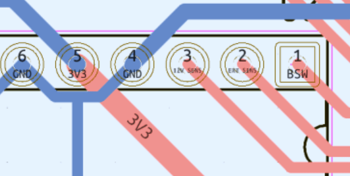

In Inkscape, I selected the whole image, then Filters > Colour > Invert… and chose ‘Invert lightness’ then Apply. This is what I got:
All good and I can just about read the net names on the pins. Its unfortunate that there is a blue cast on the background. I don’t know where it came from, but I can manage with that.
