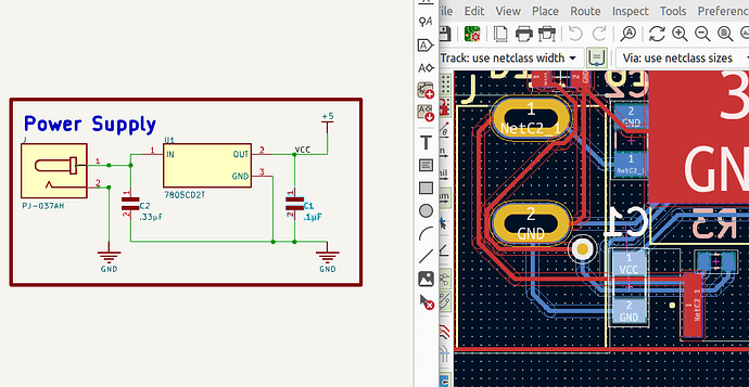

I imported it in KiCad V8.0.9 and cross probing worked immediately after the import. Note the highlighted capacitor on both the schematic and the PCB.
It was some years ago that I last tried an altium import, and apparently the importer is improved since then.
Try to reproduce this result, and then report back.

I just tried that and was able to import the project into KiCad 9. When I tried the cross probing it worked with the GND net, but not with any other nets. So maybe there is an import bug in 9.x.
