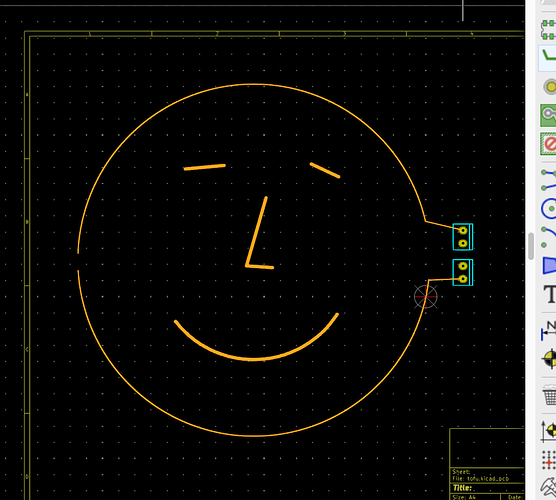

Perhaps consider mastering Array’s of a Trace could inch you toward getting what you want…
I couldn’t resist the temptation…
In 5.99 this works in “highlight collisions” mode if the tracks end in the middle of each pad. Meaning that there’s no push’n’shove and it’s not fully automagic, but with a bit of luck you don’t have to redraw everything.
I have done (pre 5.1.6) the circular antenna by drawing it at another layer and then changing each arc layer to copper layer. Of course no DRC. I will get that PCB soon.
Excellent solution :smiley:
