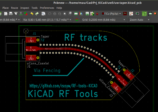

Use the RF-Tools plugin from the P&C manager.
On it’s github page there is this screenshot:
via-fencing-preview
https://github.com/easyw/RF-tools-KiCAD
