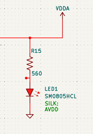

Dear Team,
Please see the schematic portion.This VDDA is going to many other IC’s.
May I know how do highlight all the nets connected to VDDA.

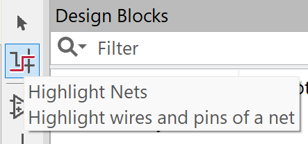

Also, if you have Net Navigator panel visible (from View → Panels) and use the Highlight Nets tools, you can see a list of all pins in that net sheet by sheet.

If you click on the line going to VDDA and then use the ` key that will highlight all the connected nets on the schematic and layout.
Everything connected together is one net.
You want to highlight all the connected wires and not nets.
