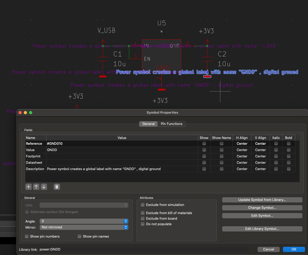

I want to hide the ‘library description’ for power symbols in the schematic editor.
I tried several things:

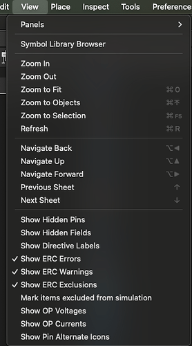

  • View > Hide hidden field > Uncheck
  • Symbol properties > Description field > Show & Show Name > Uncheck

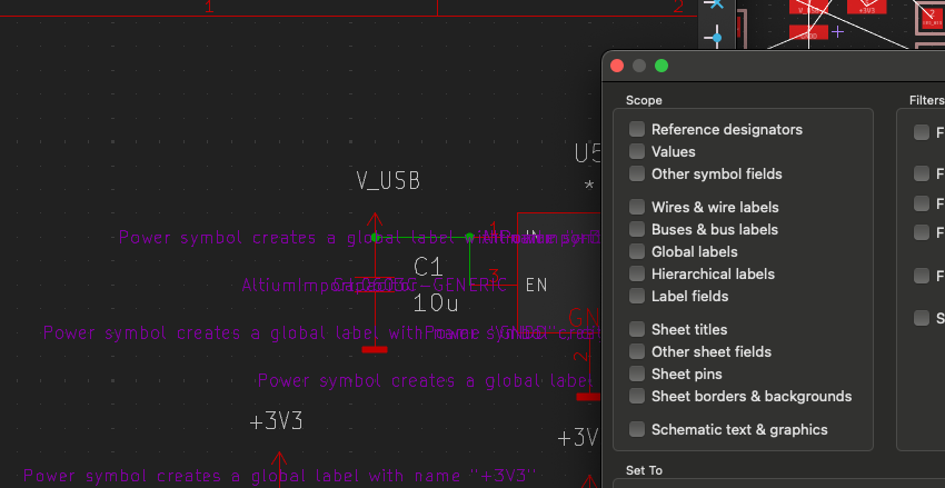

Reproduce: Go to Search > check “Search hidden fields”, type ‘a’ in the search field > ‘library description’ fields appear until re-open.
Edit > Edit text and Graphic Properties.
Select “Other symbol fields”, “Power Symbols” and untick “Visible”.
That doesn’t work, is already unchecked.
Please check the steps to reproduce.

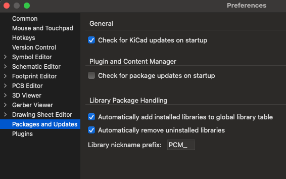

I don’t know why KiCad didn’t update tho.
afbeelding
KiCad does not automatically update itself; so this would only happen if you had some kind of package manager that you have configured to automatically install updates, such as is common on Linux.
Okay, clear. But also no notification for a newer version :thinking:
On MacOS, several applications do have semi-automated update (checking), like Filezilla shows a notification with download button.
Help > https://www.kicad.org/ > Blog.
Bug fix releases generally once a month-ish.
New major releases annually. Usually late February.
