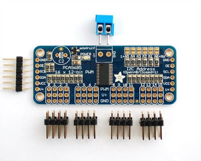

Hello, I am trying to find a symbol and footprint for a PCA9685 Dev board, but can’t even find a search button, is there a searchable master list or even a how to guide to find a component? Thanks, Losted

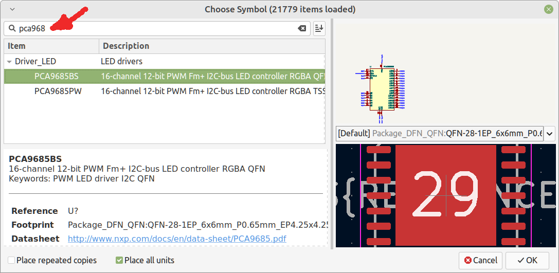

In the Schematic Editor, above the drawing area is an icon, when hovered over, shows “Symbol Library Browser”.
Click on that and you will get two columns showing the libraries and their contents.
At the top of each column is a magnifying glass icon.
Type the required library or symbol into the appropriate list beside the magnifying glass.
In your case, you’re looking for a module, so type Module in the library column.

Press a in the schematic editor to add a new symbol the empty white thing on the top is a search bar, with live updates during typing.
But it’s mostly symbols for IC’s. There are a few symbols and footprints for modules, breakout boards and development boards, but not many.

With a picture search I find at least 5 different form factors.
The long narrow board seems to be the most common and it is probably (a clone of):
Looks like Adafruit has an (older) eagle project of this on github, but I have not followed the link. Eagle projects can be imported into KiCad with a quite high accuracy, but it probably does need some cleanup.

A couple of things of note with respect to the boards you are looking for:

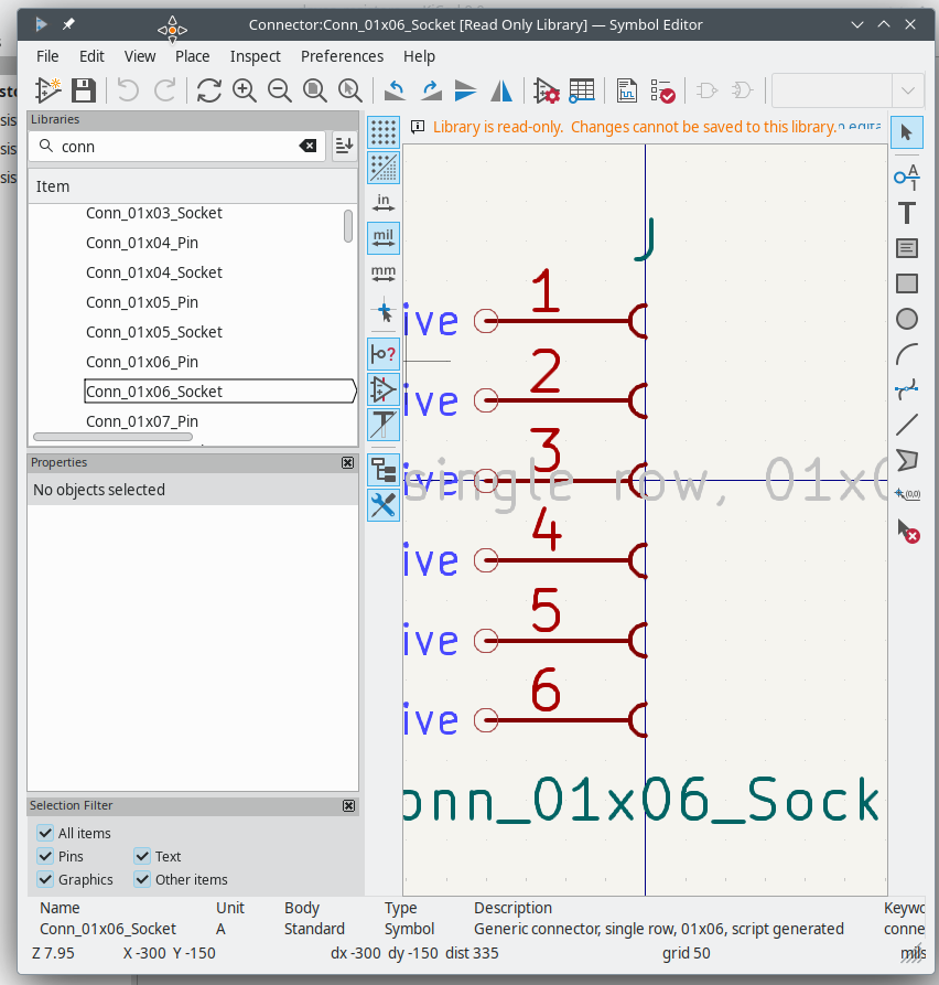

The symbol you need is just a rectangle of a size suitable to accommodate the number of pins you need.
The footprint to attach the same board to a mother board underneath, only has 12 pads, the six at the L & R ends. The power and 48 output pins in the schematic do not connect to the motherboard.
Also of note is that these development boards usually have spacing of 1/10 inch between pads so they can be inserted to a standard breadboard.
