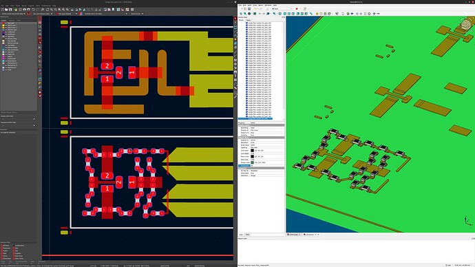

I haven’t done an EM analysis but I have done Thermal analysis in FreeCAD. The same/similar scenario may b useful…
In Kicad, export the inner layers and then, import them into FreeCAD (I used StepUp Workbench). Then, set their ‘Z’ height to the dimension wanted (naturally, would want to parrot what they’re set to in Kicad). I’ve also created custom PCB-Board Materials
Image(s) shows them after Z-setting…
