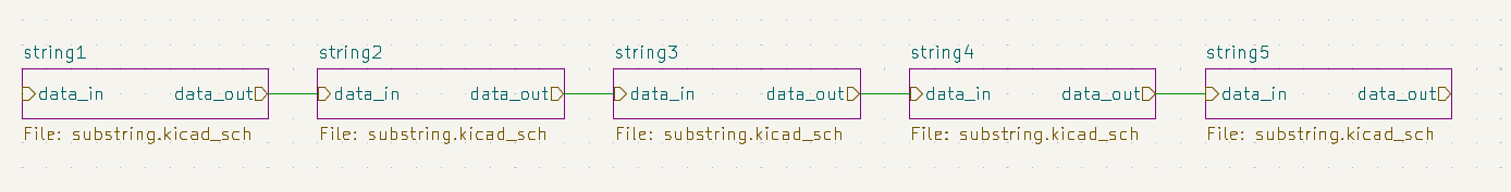

Use hierarchical labels to connect your sheets. Think of hierarchical sheets as components.
create your sub-sheet (“substring”) like this:
duplicate the instance and connect it to your first one. repeat.
auto-annotate all sheets, switch to the pcb editor and update from schematic:
You can also nest sheets to multiply repetitions. “large_string” contains 5 instances of substring, leading to 125 LEDs with 5 instances of “large_string”. You’d need to draw just 3 simple schematic sheets for this because each instance references the same sheet, but creates a new set of components and nets.
