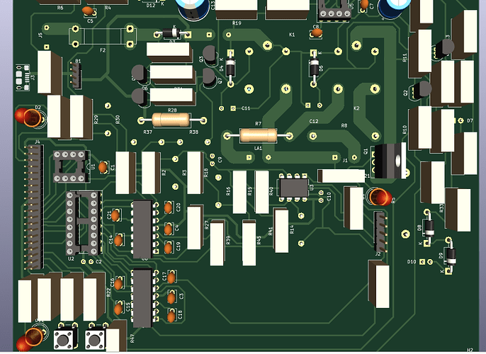

When I look at the 3D version of my board, I notice some of the chips are, well chips (DIPs). However, some are shown as sockets. I know I need to change the footprint in the schematic. Does it matter? Can I put sockets where the chips are shown and vice versa?
Also, the relays don’t seem to have a 3-D model. SRD Series from Songle Relay. I guess that does not matter.
Relay_THT:Relay_SPDT_SANYOU_SRD_Series_Form_C
The resistors are strange, too. Shouldn’t they be tubular??
Resistor_THT:R_Box_L13.0mm_W4.0mm_P9.00mm
Off topic but, as a rule of thumb, at a hobbyist level before you start designing you’re PCB decide on the Fab house you’re going to use. Then go to their site where they state their manufacturing capabilities. When found DO NOT use them but go bigger. So if their minimum track width is 0.01 then your minimum would be, say, 0.015 or 0.02.this means they can defo make your board.
Secondly there are a number of track width calculators available to use depending on many factors - the common ones would be current capacity and temperature rise.
Please remember the forum is for Kicad issues not user competence issues.
It doesn’t matter a hoot, not to the PCB manufacturer nor to you. The only thing that matters are the Gerbers and drill files.
But to be certain, check the footprints in your schematic for odd ones out.
The 3D thing is useful for creating assembly or service manuals, not much else.
And of course to give yourself a warm fuzzy feeling of being creative and having achieved something. Which is also nice, of course.

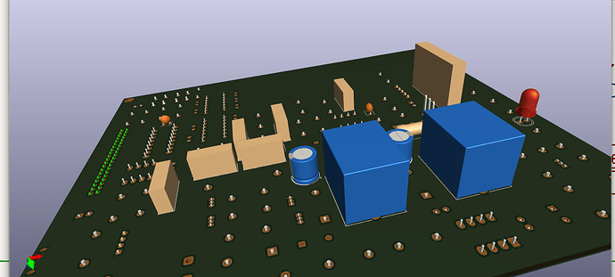

For me it looks that where I expect relays I see their legs standing up from PCB. Rotate PCB at 3D to see if there is not relay at the other side?

You are 100% correct! Here is the 3D view of the back side of the board!
How did some components end up on the back side of the board, and how do I bring them back to the front of the board?

I don’t know. You might want to use the F key to flip the component to the other board side, but you’ll probably need to check/fix the connections as they will be mirrored.

Dooh! That is what flip does! Thanks!
