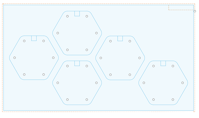

I want to design a basic two layer pcb with custom hexagonal copper pads that are routed to a single row of 2.54mm space headers in the top right corner…
This is the design:
I have an SVG of layout I can import into KiCad.
Any tips or links to tutorials on where to start with this design? In the meantime I’m going through some basic pcb design tutorials on Youtube.
IMO Much better than youtube videos
If I understand well I think you should define your footprint containing one such shaped pad.
Then design PCB exactly the same way as you would do it with footprint having single standard shape pad.
In footprint editor when you place any shaped copper on the pad and then enter this pad edition and at once exit its edition than all copper connected with pad becomes a part of that pad.
You’ve got options here. You can either directly import your SVG file (easiest is to directly import it on a copper layer). Another option is as piotr mentioned. Create a footprint from either a single hexagon, or from all your hexagons.
Relatively new in KiCad is that graphical items can be a part of a net. But with a footprint you have more options. You can add your graphics to a custom pad, which adds the ability to also add the connection in the schematic.
