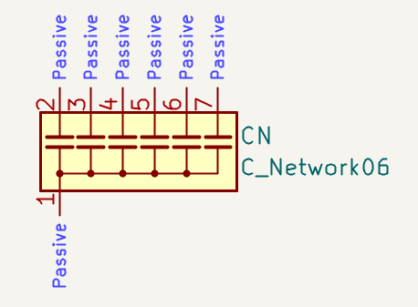

So not this ?

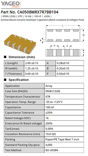

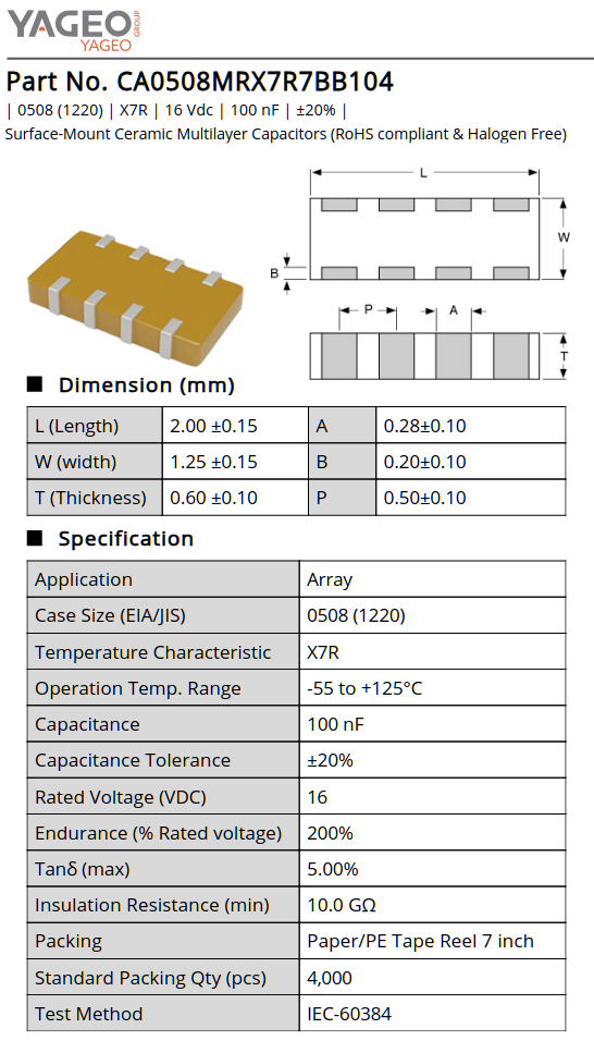

No, not a network where one side of all capacitors are connected, just 4 capacitors in a single package, like for example this: https://www.yageo.com/en/Chart/Download/pdf/CA0508MRX7R7BB104
That’s a connector. Of course I can place some part that has the correct number of pins, but I would like to have a readable schematic that has the correct symbol.

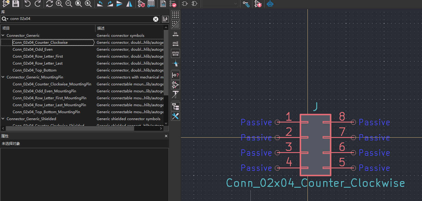

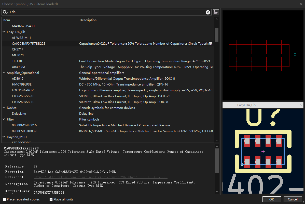

Ah . . . like this ?
Yes, like that, just that I want to use a part with 4 capacitors
A copy of a part of the datasheet:

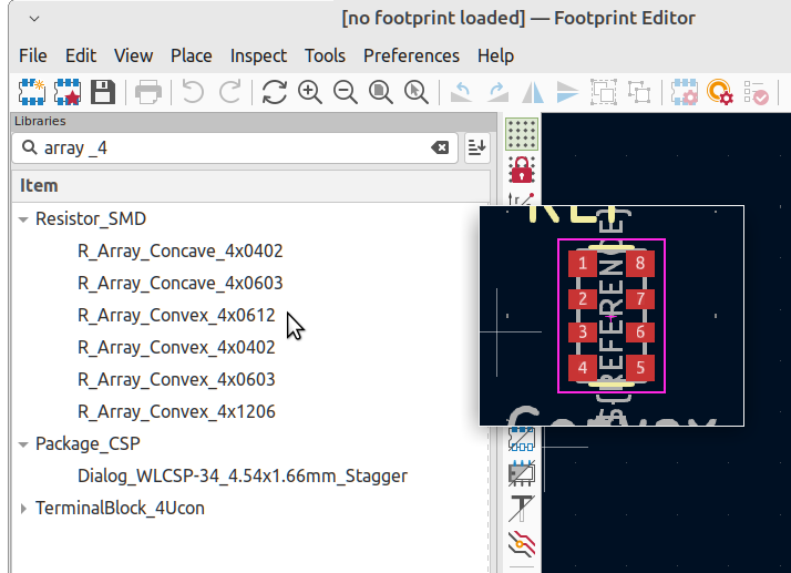

KiCad does have a few “4 part” arrays, but not for capacitors, and no 0508 size.
If this was my project, I would:
  1. Take a default capacitor, and make a copy of it in a personal library.
  2. Modify it to become a 4 unit part.
  3. either modify one of the resistor array footprints or create a new footprint for it.
There are no pin numbers in the Yageo datasheet, and there is also no indication of how the capacitors are mapped in this footprint. It’s easy to make a (quite logical) assumption, but you should really verify this.

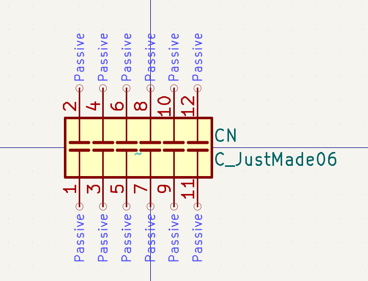

Well, I just thought oh that was easy, now I noticed I cannot connect to my part, because for some reason the pins are not aligned correctly. So not so easy after all…
The pins have the wrong spacing or they are just not on the same grid as the rest of the drawing?
Open an existing symbol that is similar, save a copy to your personal Library, open that from your Library and modify it, that way you keep many features on the correct spacing.
They had not the same grid as the rest of the drawing.
I used an existing symbol (the resistor array) and I made the part slightly smaller, as the capacitors are smaller than the resistors, so I moved the pins.
For some reason KiCad does not seem to be able to open kicad_sym files, I had to edit the symbol in the schematic and then export it again.

The above are all misconceptions. Libraries, Personal or Kicad, are not shared with projects. Only the symbols used in the project are shared.
All pins for symbols need to be placed on a 50mil grid. If space is a real premium, 25mil may be used, however, in this case the pin numbers will overlap each other.
Kicad library symbols are Read Only.
This means they can only be edited on the schematic or if moved to a personal library.
You say Symbol so I assume you mean Symbol . . . . symbols are symbolic, they don’t need to be smaller just because the physical part is smaller, they are symbolic.
Footprints are physical representations and MUST be the correct size.
